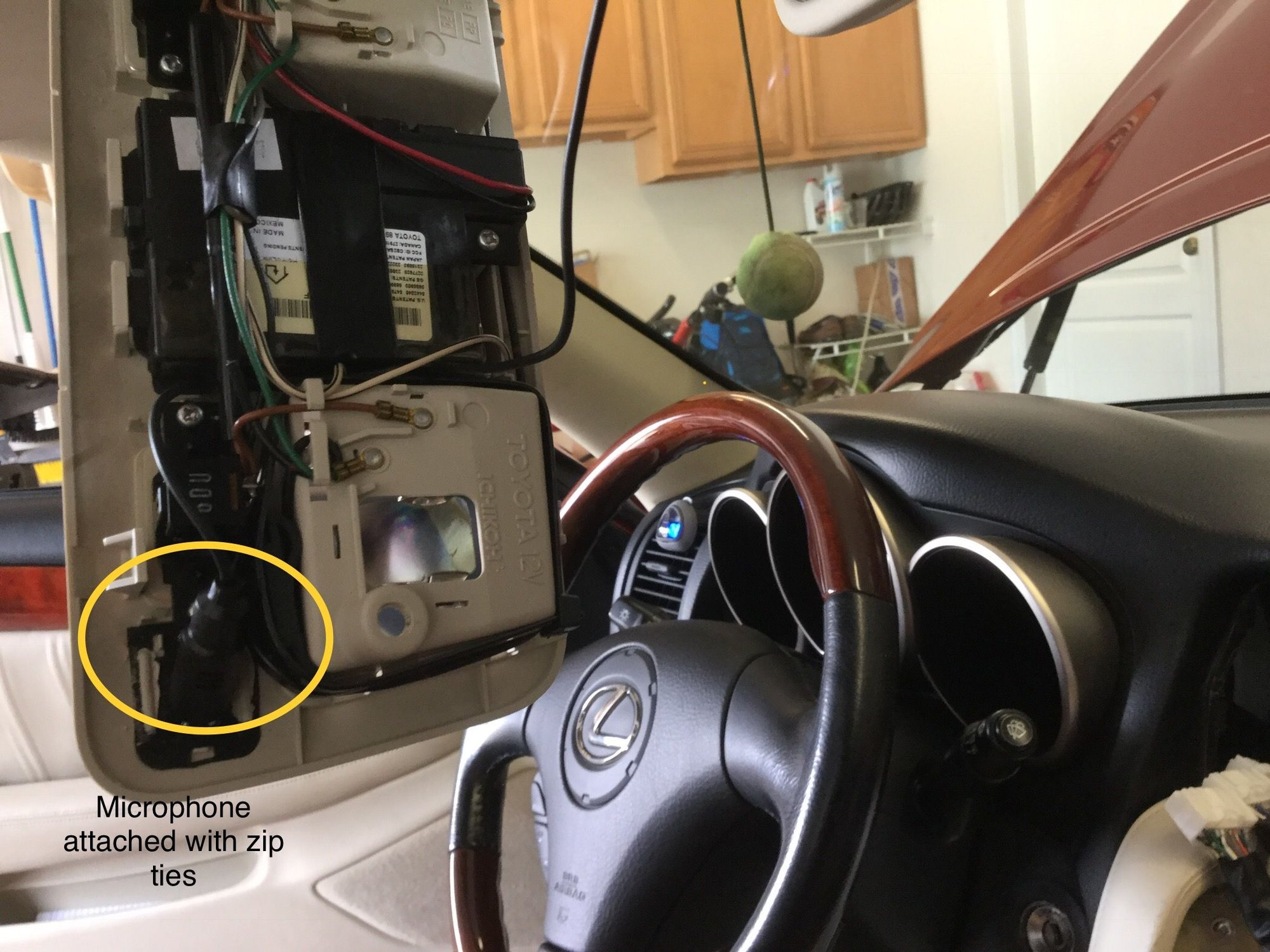

i don’t mind installing a GTA Car kit module or the USA Spec one.
the problem is that I would then have to use their microphone and wire the microphone too. I actually asked the manufacturer if GTA kit and they said I would need to wire their mic.
The 2006 comes with Bluetooth for phone so I was hoping to retain the factory mic. The aftermarket mics are not very slick looking.
to those that did it, where did you install the mic so that it’s not too obvious. Is there a way to use the factory mic?

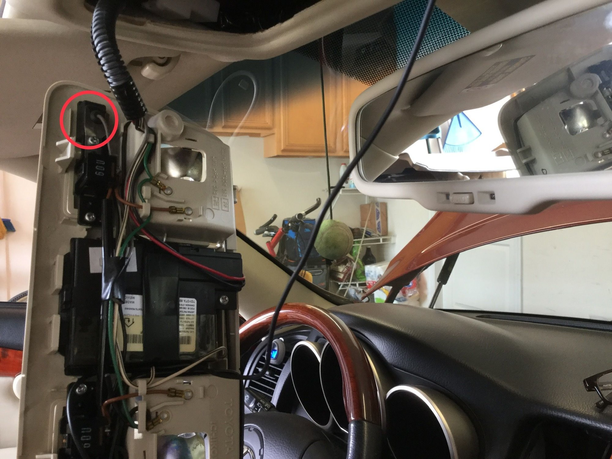

Factory mic is circled in red at the top of this pic...
Simple installation.
the entire install is in another thread.

In case you need it, here is the post where BGW posts pictures of the Lexus instructions on how to take out the console light. Sorry GMan, It doesn't show how he routed the wires.
https://www.clublexus.com/forums/sc4...acement-2.html
