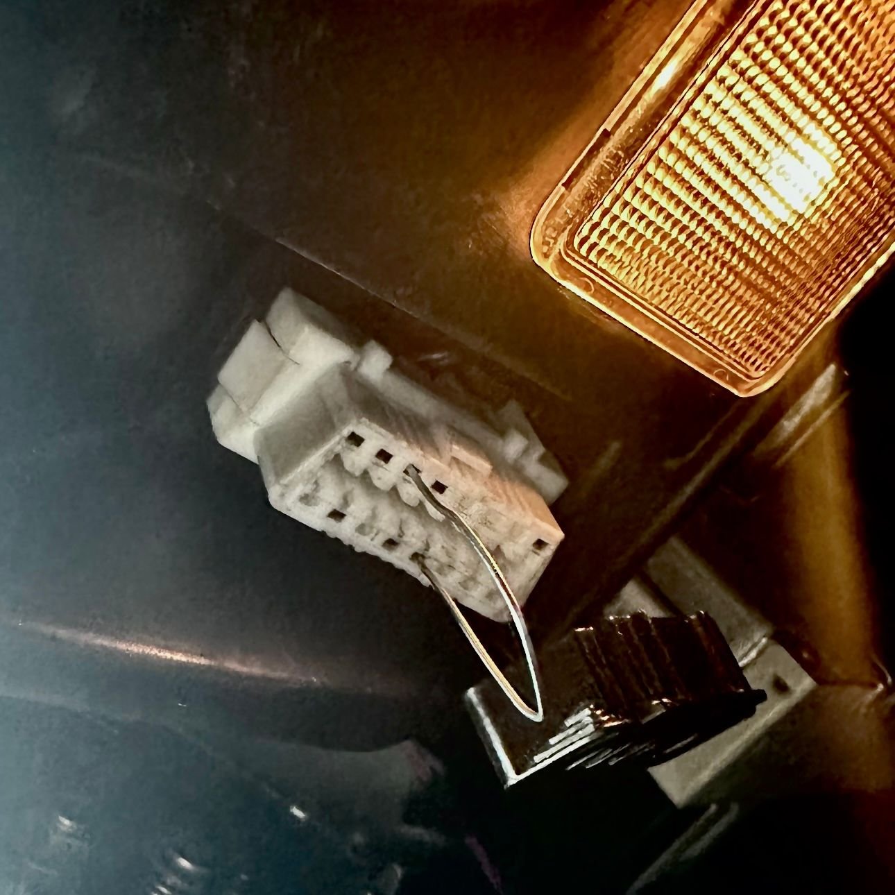

My VSC lights stayed on after my mechanic cleared a loose evap CEL. I swiped a paper clip from my office and cleared them out for good using the steps in this thread. For anyone who has a hard time parsing written instructions, I also included a picture of my assembly:
Hole 3 on the top, hole 5 on the bottom.
I popped the paperclip in, turned the car on (not start), waited for the VSC light to flash, turned the car off, pulled the paperclip out, turned the car back on for ~20 seconds, started her up, and did a victory lap around the parking lot!
