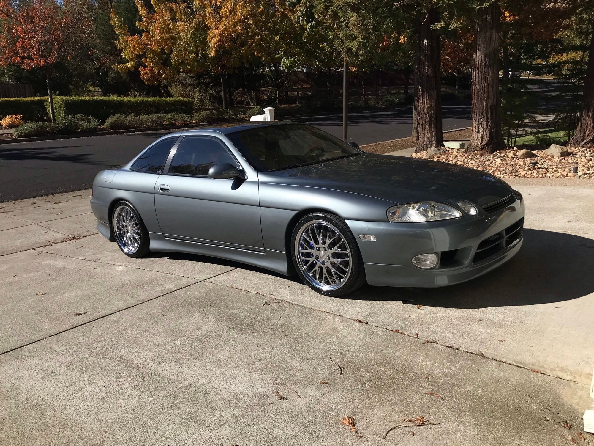

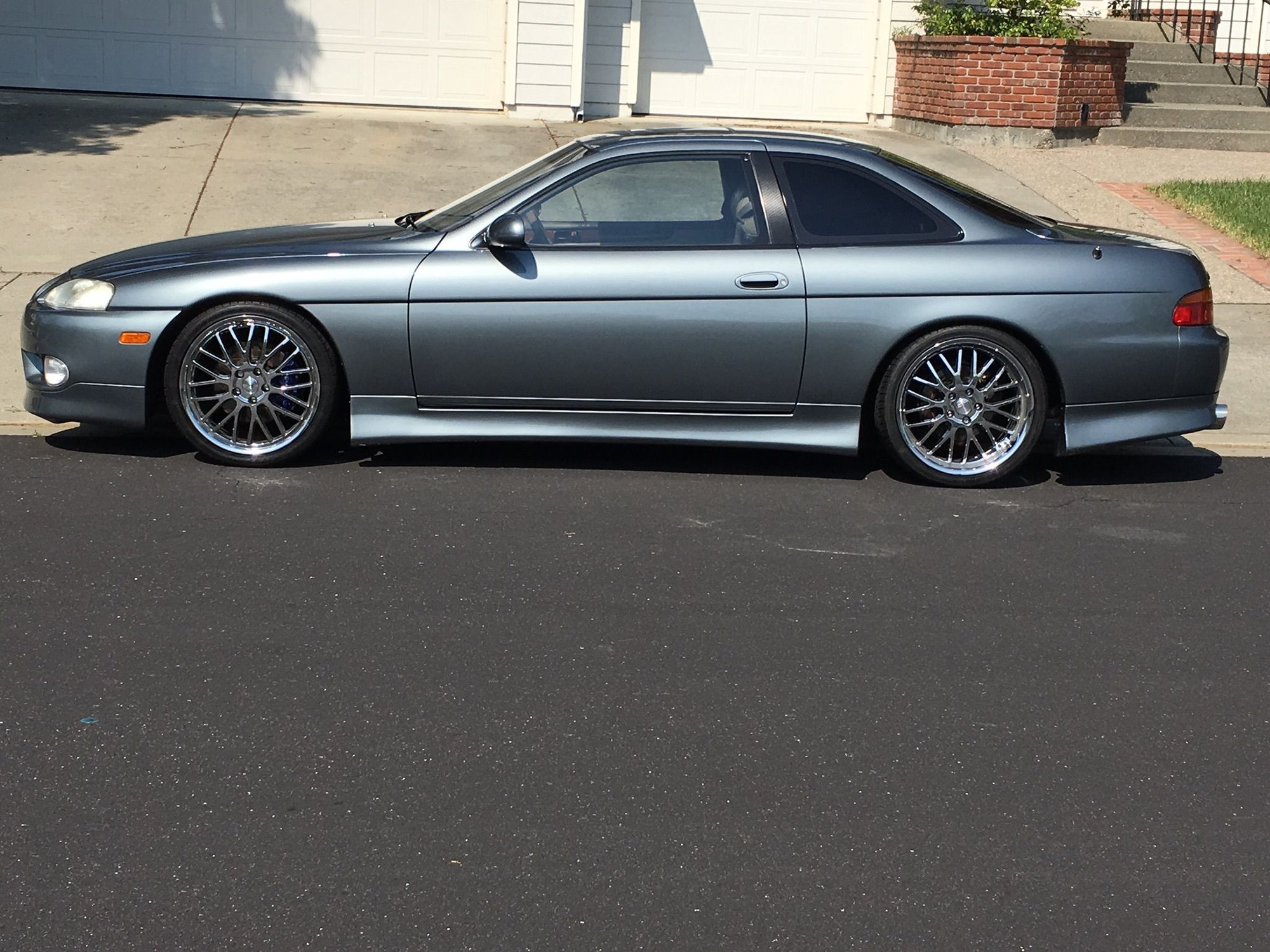

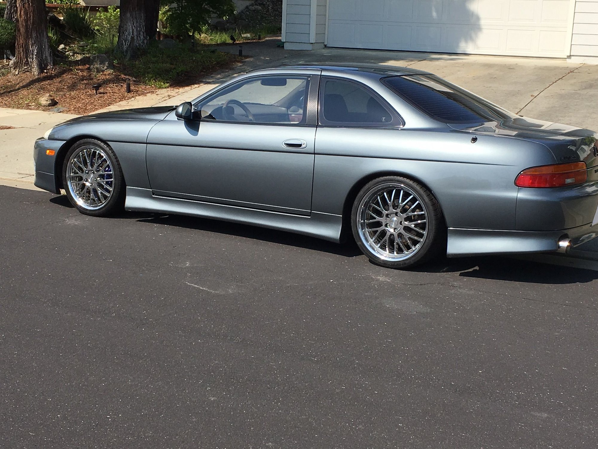

I went through all of deliberations you describe and after many months went the coil over route with 19” wheels. Also improved the front brakes with the LS400 calipers upgrade.
While not as comfortable or “smooth” as OEM struts, the coil over path offers height adjustment and stiffness settings (when you select coil overs with stiffness settings) to exploit. In my case, I worked with an experienced shop that accomplished my request to lower the car, improve the handling, but avoided fender mods by setting the stops to not rub the tires. (Need to study the wheel Fitment thread to select wheels with correct offsets for this - avoiding spacers is a must, IMO). Specs in the signature block.
Here is where the car landed:
