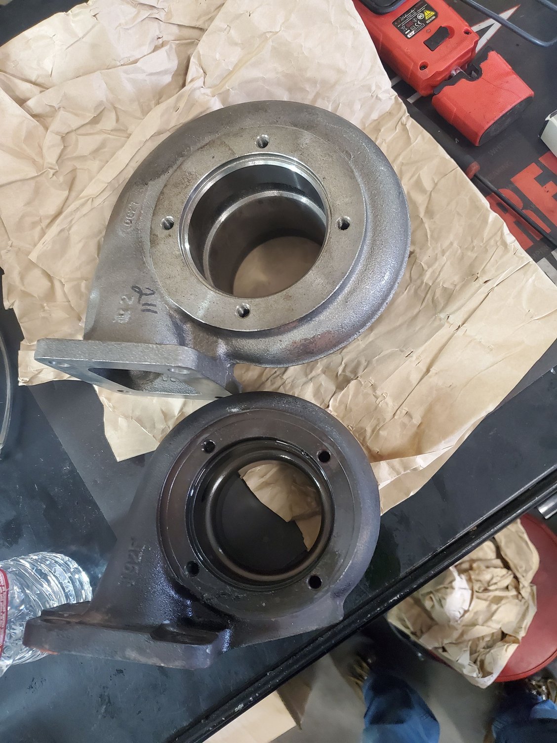

My Xs power turbo finally died, exhaust side leaking oil. I bought a Borg Warner Sxe362 and its ****ing massive compared to my "67" mm xs power one. Like wont fit under my intake with the xs-power exhaust manifold. The wheel in the impeller is smaller than the xs power wheel but the outer size of the Borg is much larger.
What turbo have you guys use'd with the XS power manifold?
Do i bite the bullet and just get a Treadstone for another 400 and a new 2 bolt wastegate for 250? xs power has a 4 bolt wastegate flange

Xs power had smaller hotsides to clear the throttle body. Borg stuff is usually bigger, I think you will need to do a different turbo manifold, different intake manifold, or cut and weld an angle on the throttle body etc to fit that turbo.

I got a .83 twin scroll borg housing coming the smallest they offer with the sxe300 series of turbos so we shall see if i can get it in there or not. I did order a rebuild kit for the xspower turbo either way.

Well Update for everyone in the future the BW S300 series will not fix with an xs power manifold. i went with a garrett gtw3884

It was the XS power one. I really would have bought another one from them if they had ANY customer service.... i've got a 64 mm garrett on there right now. gtw3884 64mm .83 ar divided and it feels about the same but much smoother instead of spiking to 20 psi. pics coming soon. i had to modify the throttle body a half an inch cut off to make it fit.

That was a good move. I would up moving to a tread stone. That move requires a different downpipes and a 44mm wastegate adapter. I also had to port-match the wastegate hole. I do love the tread stone though. It is SUPER responsive!

With some work , a Borg Warner S369sx-e will fit on the thread stone manifold. I even fit a Precision PT-7175 CEA . Check my build thread , I had pictures there.
I use a Borg Warner S360 now on a very responsive +600rwhp vvti NA-T setup . Always use the smallest turbo that can get you into your power goal so it is not laggy but will still get you on your power goal.
