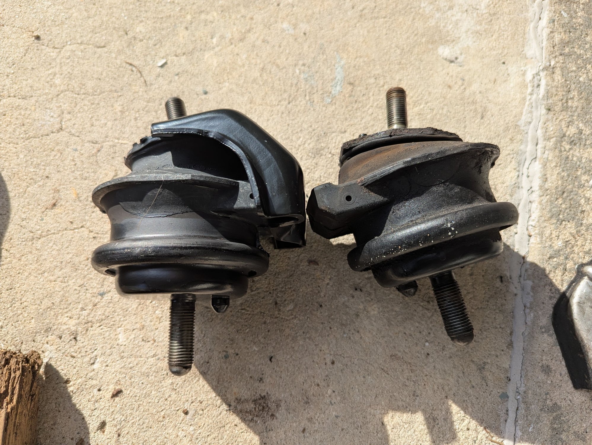

Default Engine mounts + Brake booster + master cylinder rebuild + fender liners
Was planning on doing some suspension work this winter but seemed like my brakes had other plans. While visiting a friend my brake booster went out. Good news: it failed right as I was pulling into a parking space. Bad news: the parking space was 2 hours from my house. Decided to carefully drive the car back in the middle of the night when there was no traffic. Stressful drive but got home with no incidents.
Ordered the booster and decided to do the master rebuild along with it. Of course rock auto sent me the booster for the LS400 but I had to make it work since it was the only decent brand I could get.
While the car was up in the air I also did the engine mounts........I think it was hands down the most frustrating thing I've ever had to do on this car.
Pics:
Passenger engine mount, new one on the left
Driver side came out in pieces, definitely needed to be replaced
