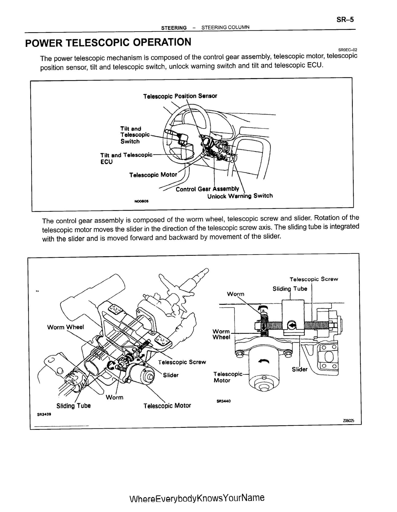

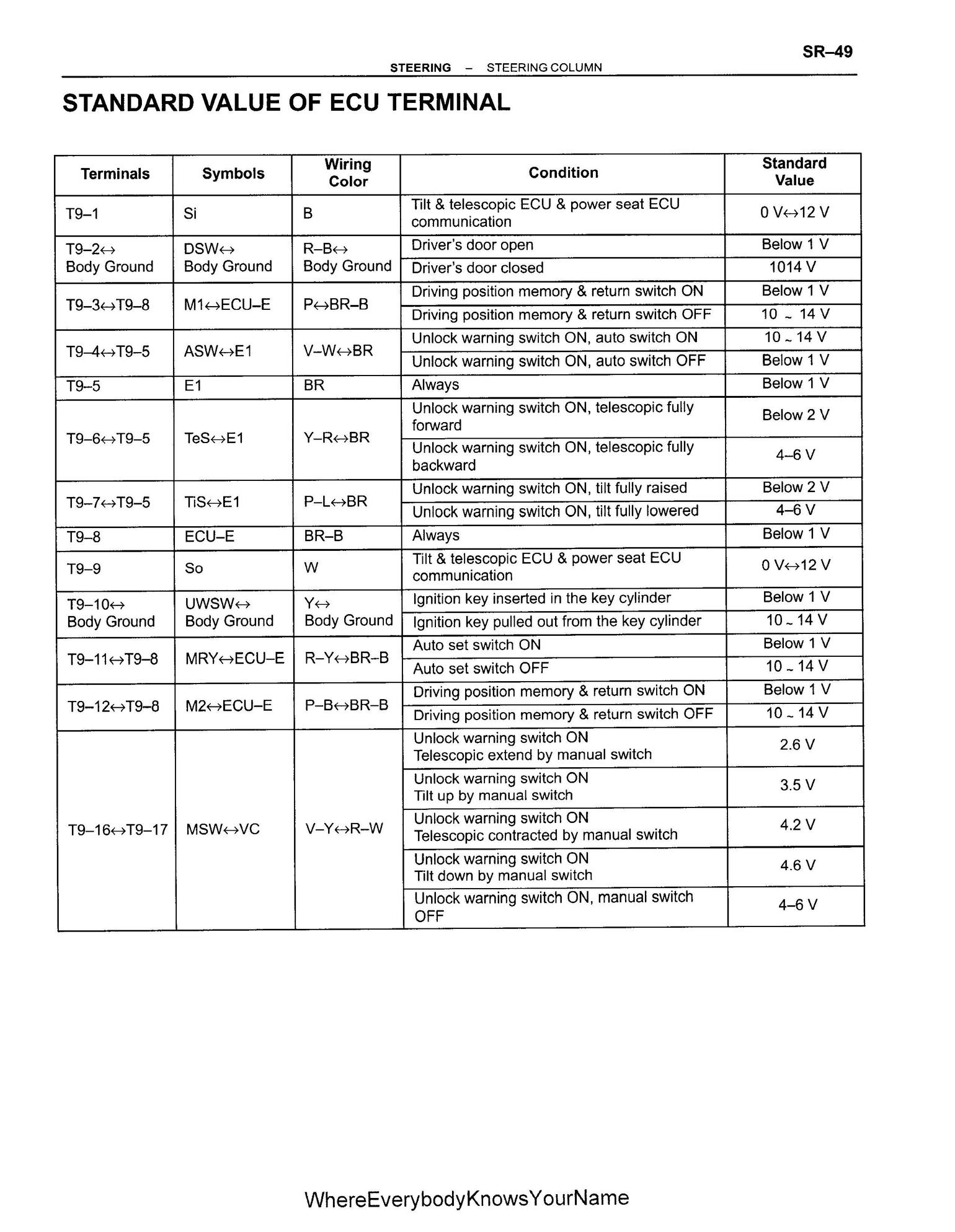

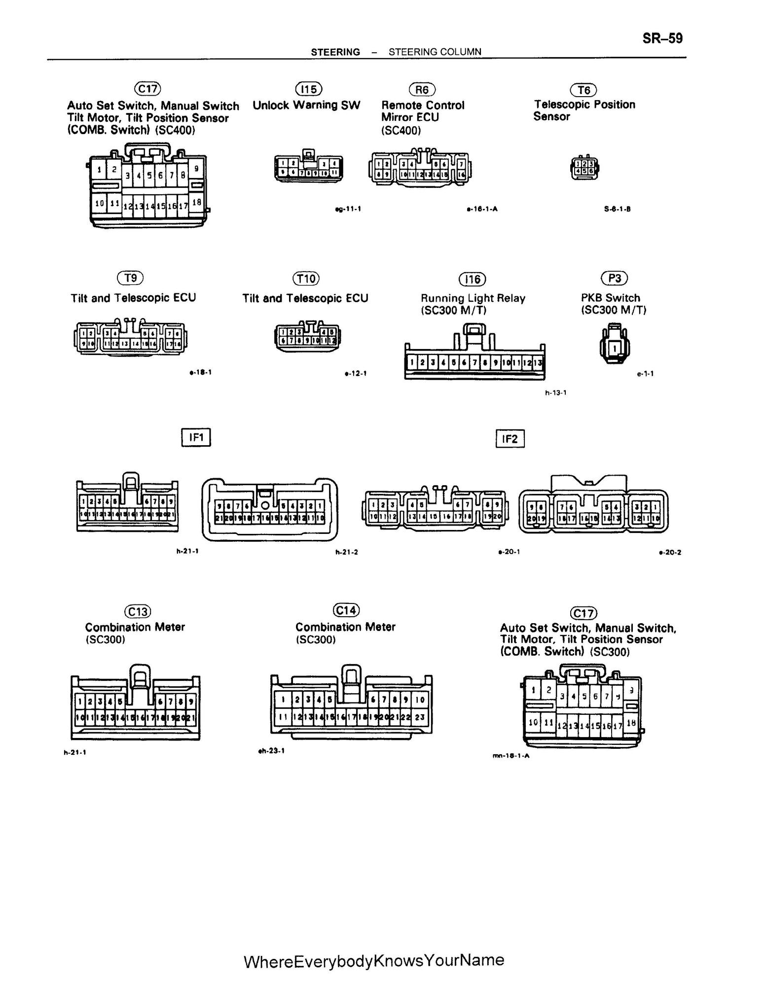

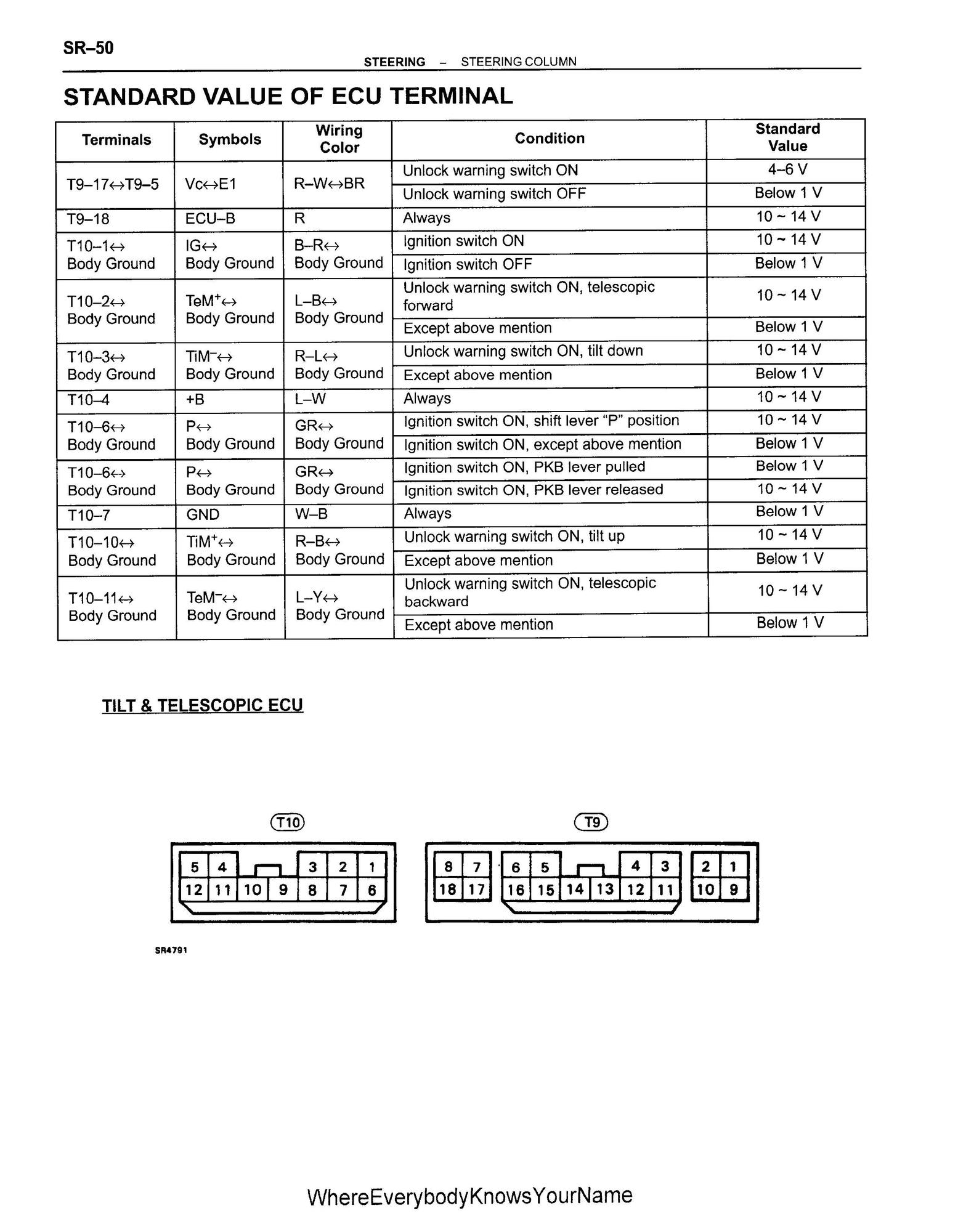

for tilt function starts at page 4018 to about 4024. this gives you ALL the information you will need. I tried to cut and paste from it but just get the characters on the left of the page upon pasting. tried to print just those pages but keep getting error message. so you may have to go to the website and download the manual or flip to the page in a pdf reader.

I less time consuming thing to do is locate the connectors to switch on the column and unplug it and check your meter. then move on to the other components. they seem to be all in the cabin under the dash (i think). you will have to read the manual to verify that and give you the color and type of the connector you are looking for. Good luck.

Here is manual pages that could help to understand the wiring and short issue my worm gear has an issue of popping out of position and not working so i have my auto switch turned off cuz the steering wheel won't move from its current position. good luck.
