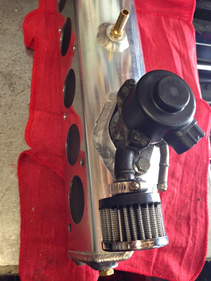

goign to add some pics of where I put my IACV and vacuum lines for others to get ideas. you can put them lots of places but I put them here so I can still reach the oil filter, and the vacuums on the back so they are hidden but still possible to get to.
The one vacuum bung in the middle of the plenum is for the map sensor and FPR, I always install the map sensor in the middle of runners 3 and 4, cause well that is the middle of the plenum and I want the reading there. I like to tie the FPR to the map sensor so they work in conjunction with each other fuel pressure and what ecu sees is same.
The 2 back vacuum bungs, one of them goes straight to brake booster like factory (important to have a dedicated line for brakes), the other one goes to a vac block that feeds all the other stuff in the car (BOV, heater valve, boost gauge, other stock stuff etc..)
I want to say the weld on aluminum bungs were 1/4" NPT threads. that is a good size for a 1/4"npt to 3/8" barb for a 3/8" hose like the brake booster line and also for smaller stuff you can just use a smaller hose barb like 1/8" or 1/4". always use liquid thread sealant (comes in a small white tube) on the threads don't use teflon its not a bathroom.
slightly modified sc400 IACV, fits on 2jzgte flange just fine.
Mock up shot on a spare GE motor to give an idea where the stuff sits.
the GE motor in this pic has a gte oil cooler on it and the plenum had straight vacuum fitting in the back but those became 90 degree ones before going in the car.
how its sitting now, I may think about flipping the throttle body sometime but the throttle cable will end up on the other side will have to get a tab welded if I do that.

Awesome, thanks for the photos, they really help! I ordered my FFIM last night, so will work on getting the IACV and vacuum bungs welded up while I save some more scratch for a TB. After going back and forth and reading everything I could, I think I finally decided to just bite the bullet and get the RMR TB and call it good since it comes with the TPS adapter and bolts right up, plus leaves plenty of room for me to work with pipes.
no problem, by my third ffim on this motor I pretty much figured out where I wanted everything so thought it would be helpful to share some pics. I really took alot of time deciding where the vac bungs would be and the IACV, the oil filter is hard enough to reach without sticking the IACV in the middle of the plenum like some designs do.

ecu does not complain about it missing but I would go ahead and install one, its just a matter of getting flange welded and finding a sc400 IACV. both are not difficult and will help you idle properly.
without it its annoying to say the least, you will likely have a high warm idle, the warmer the engine is the higher the idle will go with the same amount of air. if you raise the cold idle enough to idle on its own, then the warm idle will be too high. if you set the warm idle right, then it wont idle cold unless footing the gas constantly. it gets old quick and then you wonder why you didnt do it in the first place when it was easy to access and sitting on your desk.
Gotcha, I might as well just get it done while I have it all apart like you said. I have the tb and weldon bungs so I just need to order the flange and find an iacv and I'll be ready for mockup and weld. Still have to relocate the ps stuff before I can mount it anyway. Thanks for all your help, you truly are a wealth of knowledge, you are very much appreciated!
all the sc300, supra, sc400 have the same IACV connector, simply unplug and plug into new one.
the sc300 harness does not need to be extended for the IACV, simply unwrap the harness and you will see the wires are very long (since they go to passenger side normally) and peel it back and it will reach anywhere on the drivers side.
the coolant ports on the IACV you don't hook up, I cut them off or pull them out usually (they are press fit in), but in that mock up pic they are still there. the only thing you need is the main connector and a small air filter (if you run a map sensor based ecu) or if you have a maf based ecu run a hose to your intake pipe behind the maf.
