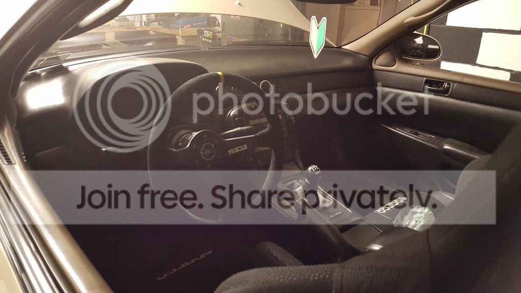

Everything has been good with the car so far.....been up and driving it now for about a week. The Tremec is a very mechanical feeling transmission....but that is probably a good thing....
Only complaint I have is that the clutchmasters single disk with the flywheel is very loud....i.e clutch chatter due to lightened flywheel.

Awesome that it's working well so far. How is that shifter? Do you have any of that side to side "arch" kinda feel I was talking about?
Old Apr 19, 2017 | 12:28 PM
  #960
CatManD3W's Avatar
CatManD3W
iTrader: (18)
Joined: May 2013
Posts: 2,207
Likes: 25
From: Pittsburgh, PA
No none at all...the shifts are so short with the TREMEC.
With this White Lightning shifter I did have to cut away some of the tunnel to make it work....the sikky one doesnt require any cutting that im aware of..
