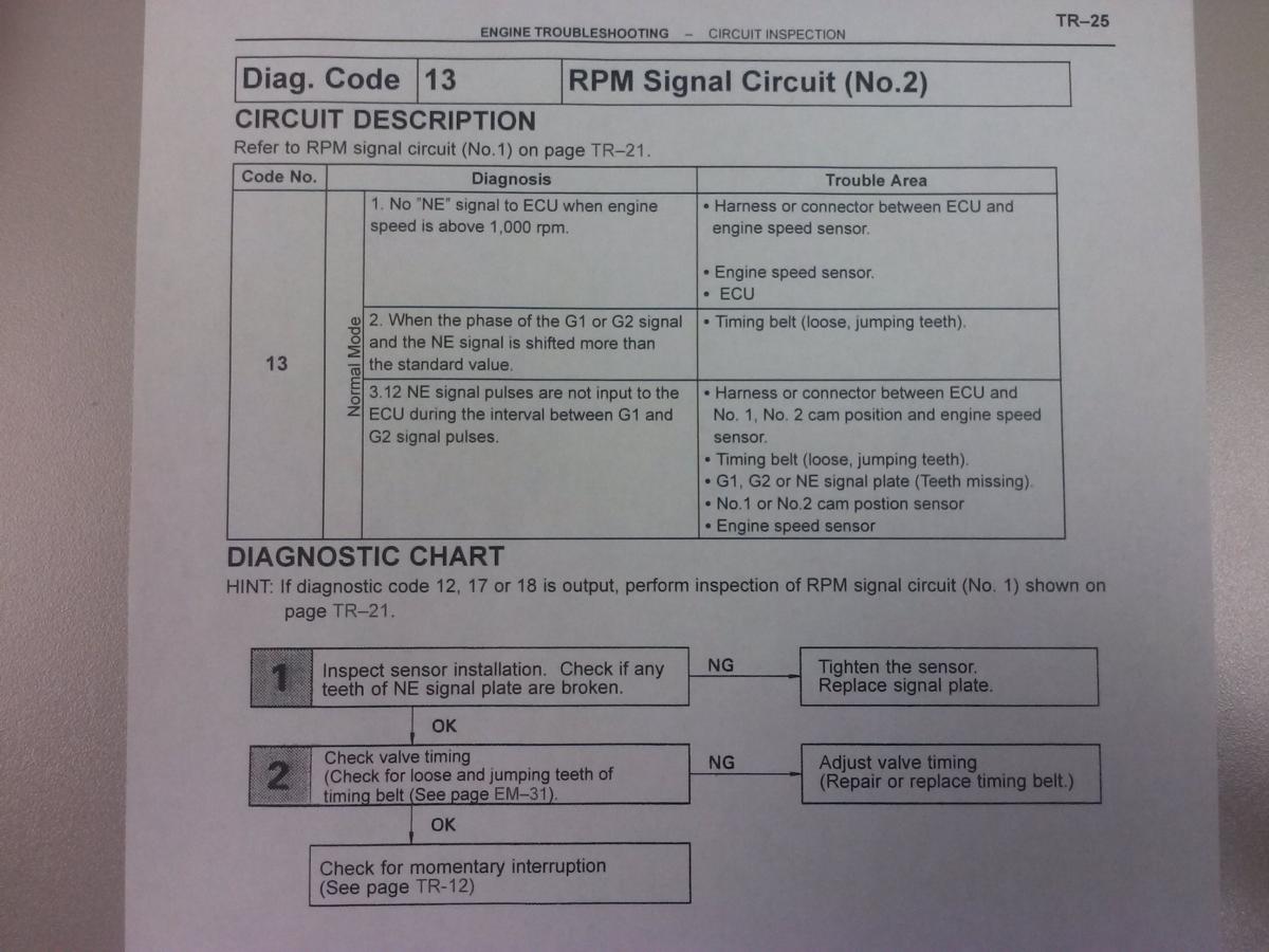

here is the engine trouble shooting sheet. hope its legible. I do not think it is timing, jumped or broken teeth, or the ECU. Based off me getting the car going correctly for a bit, check engine light went off and car operated all functions as it should (tranny shifting fine, ect), what seems more likely the culprit?

ignitors and coils usually aren't intermittent and since you have firing of the coil that means the ignitor is working.

It could be timing belt related but I don't see why it would be intermittent.
the NE is your crank sensor signal, and the g1 and g2 are the cam sensors, so it could still have something to do with one of the sensors, and the code really points to both of those as a possibility.
how many miles on the car and belt if you know? Im still leaning towards a wiring or sensor issue, try playing with the frayed sensor wire that had the insulation damage, but if most of the strands ar broken or frayed it should be repaired, try playing with more stuff wiggle that wire and check the cam crank sensors.
