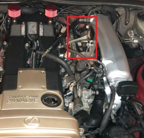

Hey guys, so after years of slowly working on my car here and there i started it up for the first time on the na tt ecu mod. I have a few questions. On my iac flange there is a vacuum nipple under the flange. What am i supposed to connect that to. A filter or to vacuum. Also my fan was spinning at full speed the whole time and did not stop. My car has always had a problem with the ignition switch. It doesnt crank, I have the starter hooked up to my own switch with relay which i dont mind but my cluster lights are off and wont turn on. Ive checked all under fender wires, i even switched to gte ecu, I redid most of my engine harness, swapped to 98 cluster. I changed all relays in fusebox, but yesterday when cranking for oil pressure I pulled the efi fuse out and noticed the cluster lights turned on. For 3 years I havnt figured it out. only thing i havnt changed is the ignition switch in the car. Im going to be back with some more questions soon.
MODS
92 SC300
2jzge
2jzgte headgasket and arp studs
ffim
fluidampr
440cc injectors
aeromotive fpr
walbro 450 pump
built r154
S360
And a whole bunch of other mods
