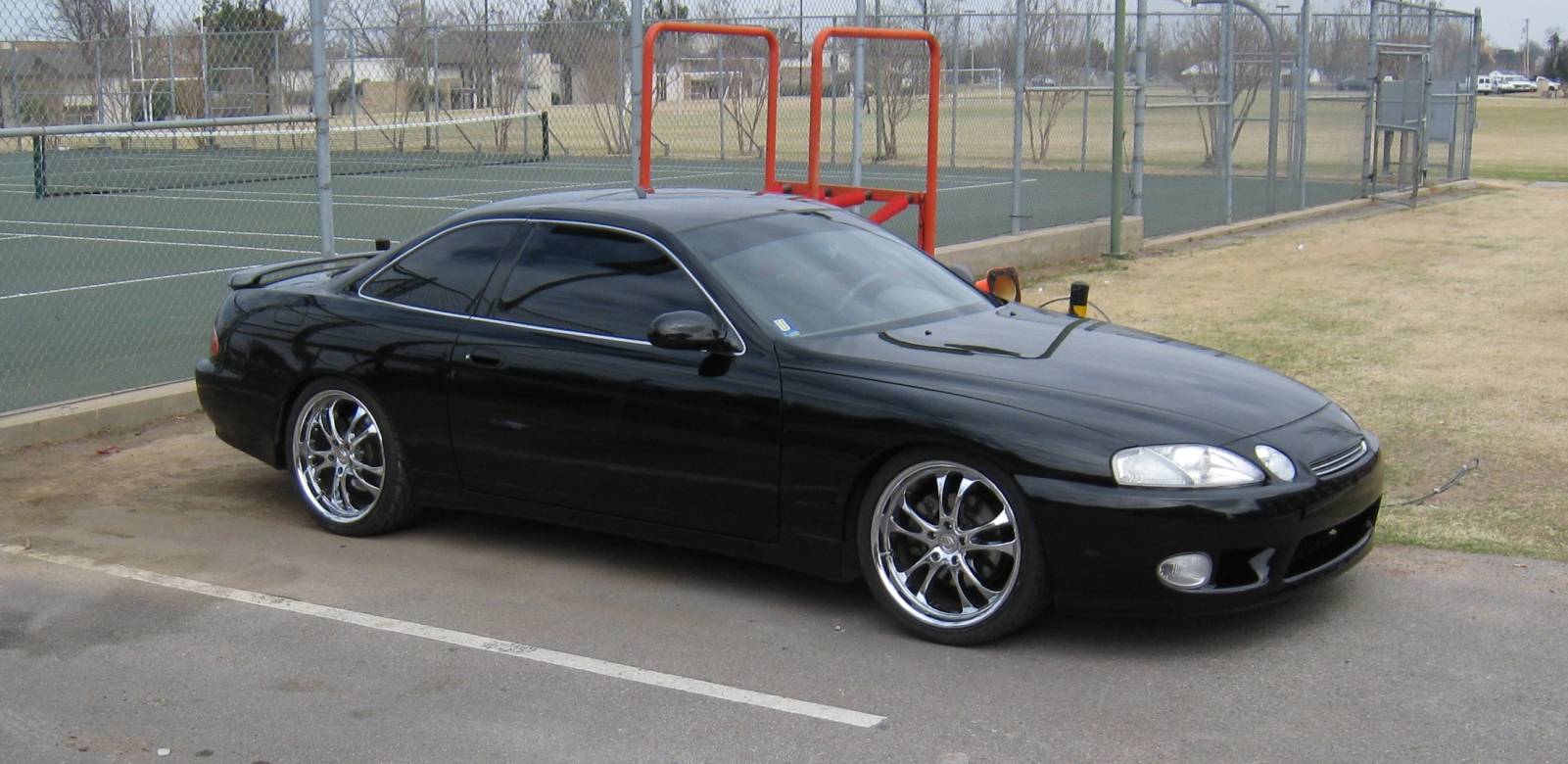

In the world of paint, i have taken on a project i don't think anybody has ever done. I have always really hated the side marker lenses on our cars, i feel that they really ruin the flow of the car. So.... i molded them away. I also molded off the center cross link in the lower part of the bumper (hard to figure out how to explain) and i debadged the bumper. I also have a couple of vertex fenders (im tired of rubbing occasionally) and a vertex front lip. I decided not to paint the lip, and im going to wrap it in CF, i just hope it will look good. First time painting, and i have a little orange peel in my clear, but when a nice day rolls around ill be wet sanding it off and buffing it to perfection. Anyway, pictures are worth a thousand words, right?
First came the fiberglass support so nothing cracks.
Say bye bye to the ugly lenses
I highly recommend anyone using these fenders to ADD LOTS of support to all the mounting tabs. I fear the paint will crack at these areas over time..
Fresh paint is pretty (homemade paint booth)
car is very dirty in picture...
Again, i apologize for terrible pictures... no sun!!

Very cool, glad to see more manual converted 400's. Back when I owned my 95...a conversion like this was something that was only tangible by thought and never actually accomplished by anyone in the country.

dang i like it man, i want a 97+ 6spd (sheesh even a w58) SC400 so bad..
i really like the shaved side marker light to! i always hated them for some reason..
i'd definetly like to see some vids.
