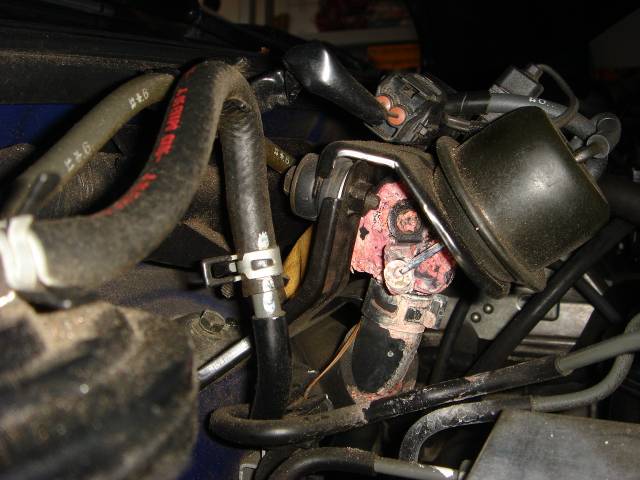

Can anyone tell me what this is and what is leaking?

Heater control valve, search it there's tons of posts.
The dried stuff you see is Toyota red Coolant.

Ahhh Pink frothy coolant.....its an easy fix. One or two bolts and a clamp.

ahh, thanx....I can finally do a search now that I know what to search for.

How did you fix it? Do I just take out the old clamps and put in new ones?
Check for sticking valve...cracked hose...cracked hose flange on valve...
then get new clamps...they are cheap and its better to just replace them that have a problem down the road
