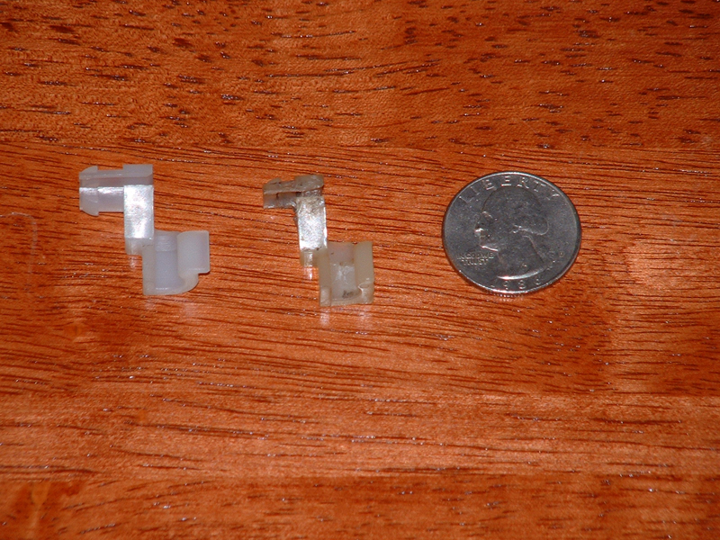

Heres a pic of the old part (middle) and new part from toyota(left), notice the plastic piece missing from the old part.

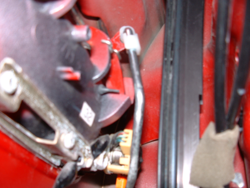

Heres the hole on the back of the door handle (left) and the rod (right).
Now, insert the connector into the door handle hole first! (Don't do it backwards like I did)Then into the rod and snap the bottom part over the rod after the bend
This is how it will look when it's done, a little grease is a good idea to keep it operating smooth.

A piece of info for you-all. The Toy P/N for the clip for the right side door is 69293-12030. The drivers door takes the other one...P/N 69293-12040.
-Courtesy of JohnED. Thanks John!
