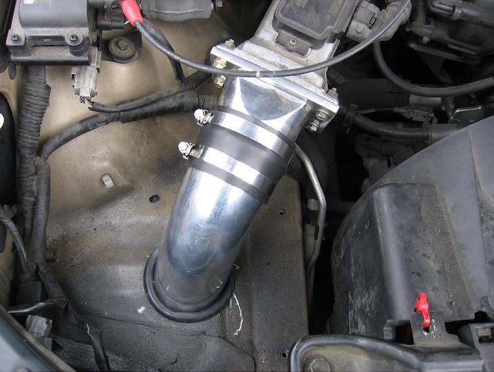

I decided to post the pics early:, I drew the circle, drilled holes, cut out the circle w/a dremel smoothed it out, then put a hose around the hole. I don't know what the pipe was originally from, my friend cut off a piece of this pipe before for his custom CAI in his silvia.
