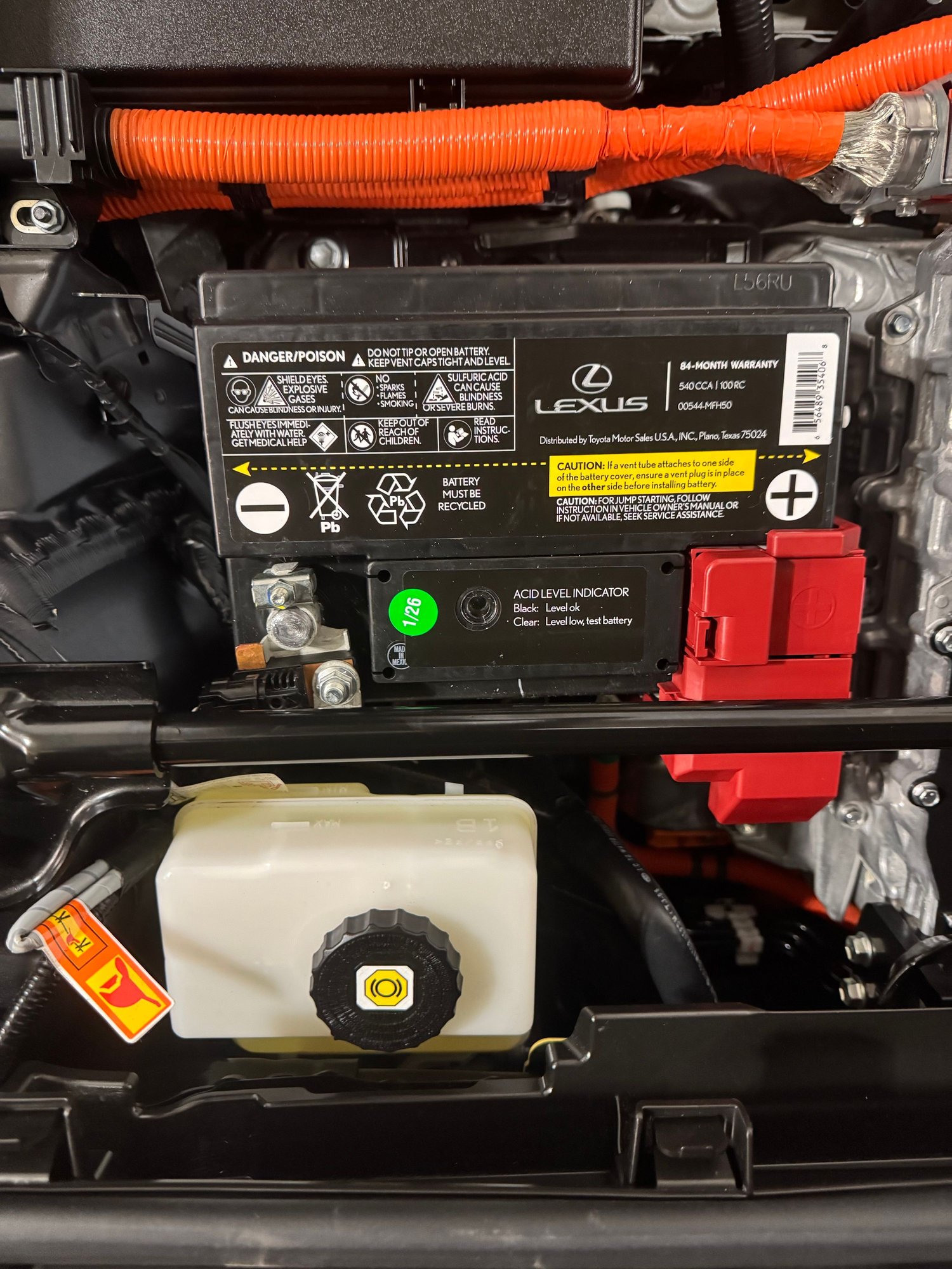

That is interesting there is a difference between the Japanese OEM battery and dealer provided replacement Lexus battery. Apparently the Lexus battery on the dealership is made by interstate.
My battery just broke at about the two-year mark and was replaced under warranty.

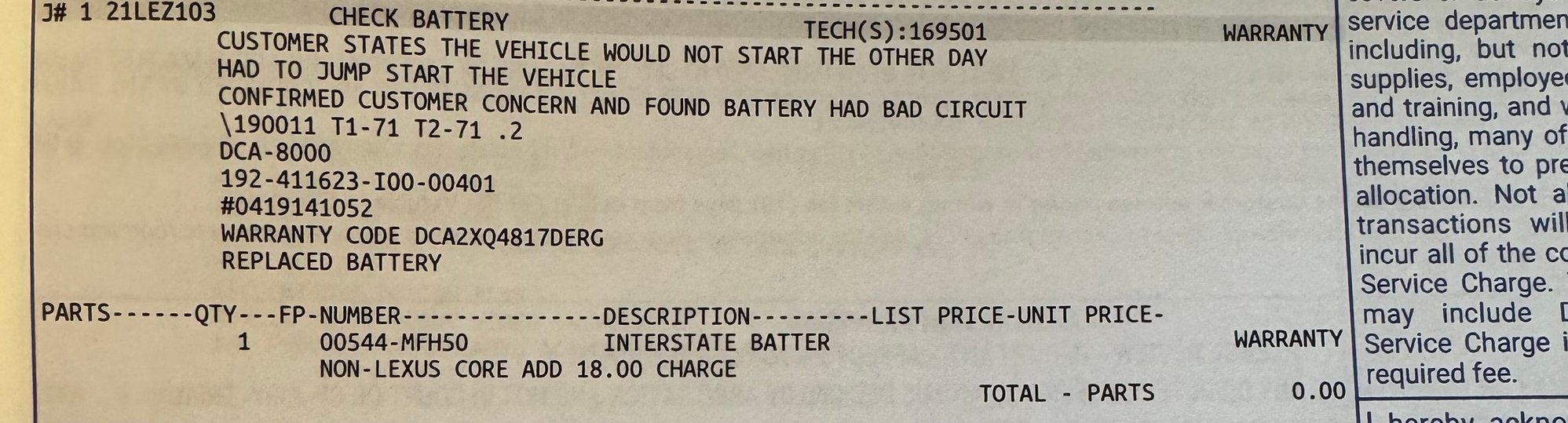

I have a 2025 RX450h+ and a couple of months ago I got the dead 12v battery in my garage…just out of the blue…no warning. The car was being lightly used basically on plug in battery. It had last been driven about 3 days earlier, and the plug in battery was fully charged. I went to the car and opened the door, and the startup tines sounded corrupted, and went silent. Pushed start button, and nothing happened. Everything electrical was dead.
The dealership had a technician who was able to stop by and give me a jumpstart. When I took the car in for service, they just replaced the battery with an interstate battery. When I asked why the problem had occurred in the first place and I had no warning, I was just told that I should drive the car more. While it is true that I am a low mileage driver, just over 3000 miles in nine months of ownership, I did not find that to be a very good answer. For a car which monitors so much,it is very disappointing that it doesn’t do a better job of managing the 12 V battery status and providing early warning to the driver.

Alright, this was a struggle. I had to take it in twice last week to the dealer. They replaced the battery the 2nd time, with a Lexus/Interstate one. At 1st they said it was ok as it was "taking a charge." However, with my testing it was losing 60% of its charge overnight. It probably would have died again in a few days.
Hopefully, all will be well until we can finally turn this RZ450e in!
