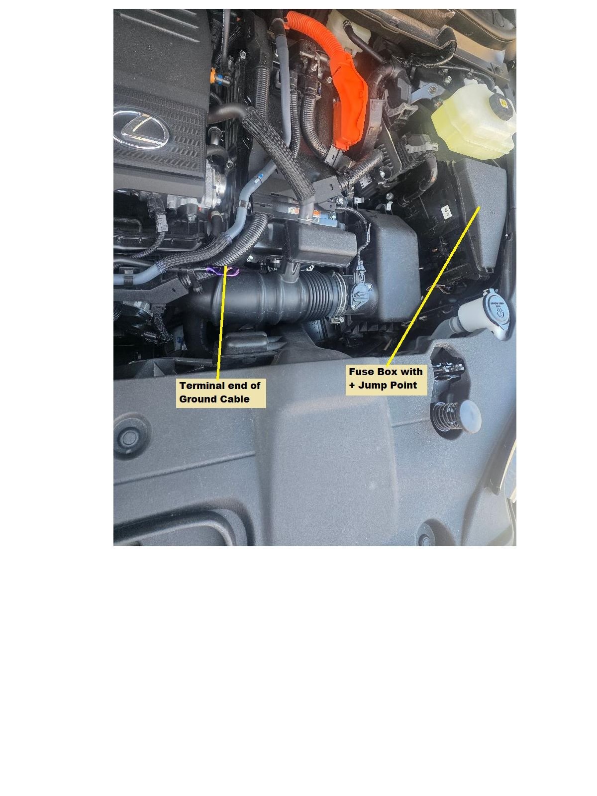

Rather than buy a new Jump Box or longer jumper cables, I bought a 4 Gauge black cable from the local auto parts store and installed it as below :
This allows my jump starter cables to reach the proper +12 and ground point for a safe jump start. On my install, I could have used a longer ground cable.
A cable around 36" to 42" should work fine. Ground cable cost is under $15. The bolt used for cable connection is already there.

That’s a good setup. Thank you for sharing.
