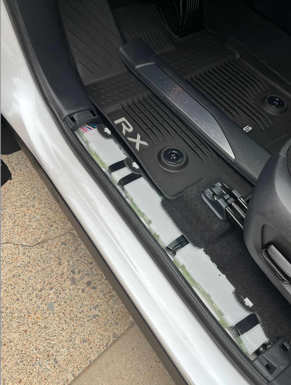

I purchased the Lexus OEM illuminated door sill for my RX. I was able to remove the current door sill (starting with passenger side) expecting to see a wiring harness under that. What I found is a long rectangular box with a white lid that I cannot seem to figure out how to remove (assuming the plug is under that). It appears that the clips should pop up but no luck so far - I have not applied significant pressure to them yet, but seems I shouldve gotten some movement but not yet. Has anyone done this for the 5th gen that can provide guidance or have directions? TIA!
UPDATE: I was able to get the lid off the box but there is no plug. I assume it is running up behind the cover underneath the glove box. So...question stands: any ideas where the plug is?

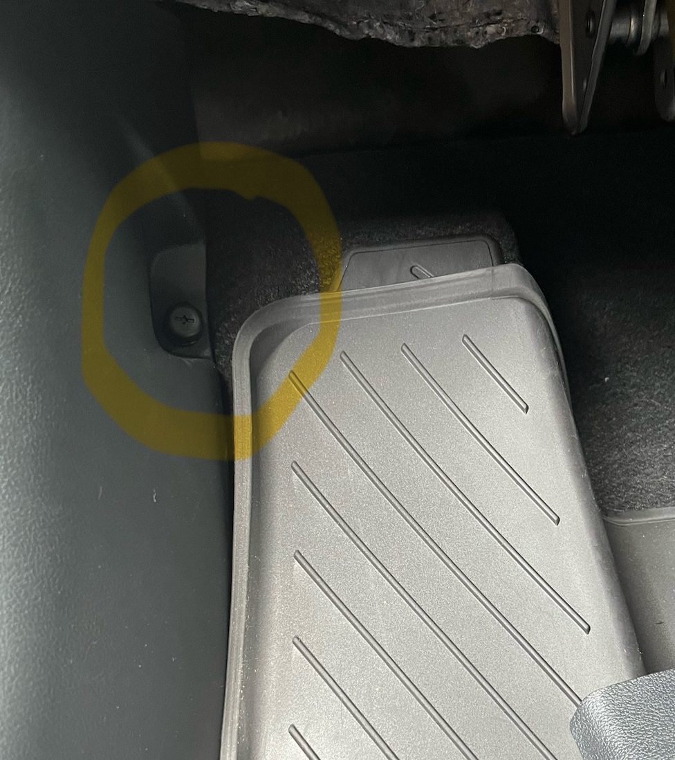

UPDATE 2: I figured it out...yes you do need to remove the panel that the door sill meets and runs up under the glove box. Very easy...there is a twist screw (hand loosen - no tool) by the foot board that needs to be removed and then panel pops off easy. Plug is right there next to door sill. Plug it in and reverse the steps and done!

Here is a photo breakdown of the drivers side install. Quick job once I figured it out on the passenger side:
Original non-illuminated sill
Underneath driver side sill - no tools just popped clips with hands to remove old door sill. Takes a little bit of force but be careful not to go too hard. I did hold the adjacent covers down with my other hand while pulling up on the part.

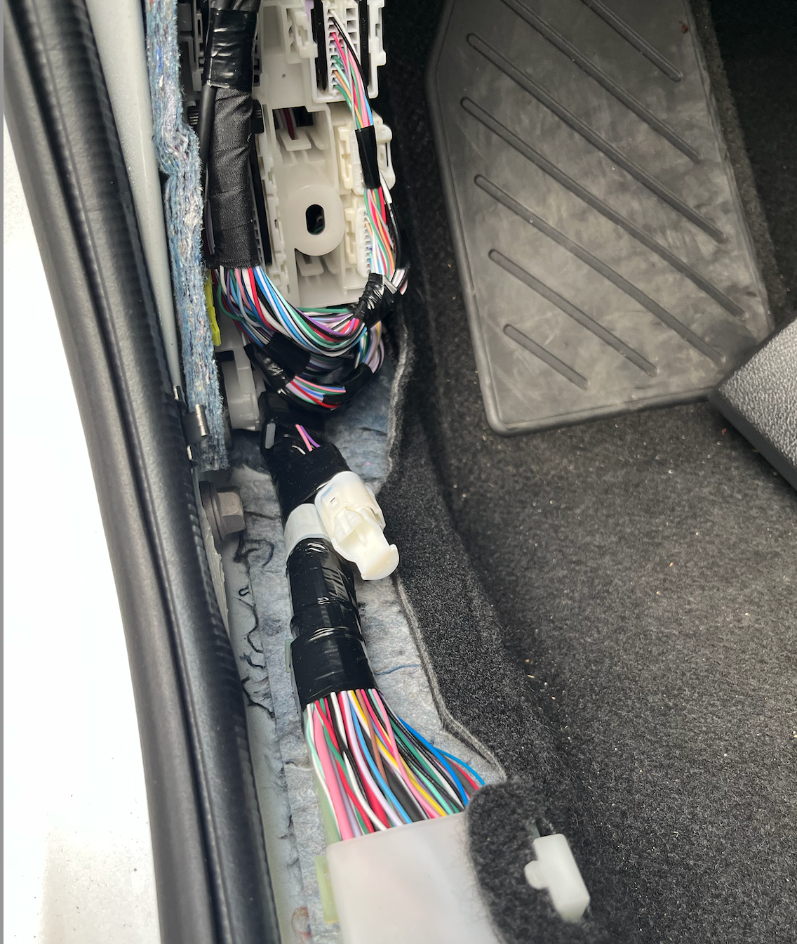

Remove cover in front of door sill next to left foot rest. Hand loosen and remove that screw and pop off cover - these clips were very easy to remove.
The white plug is where the new door sill will plug into. There is a termination plug inside that needs to be removed first by pushing down on the tab and pulling out on the plug
New door sill plug goes here after removing that protective cover in the last step

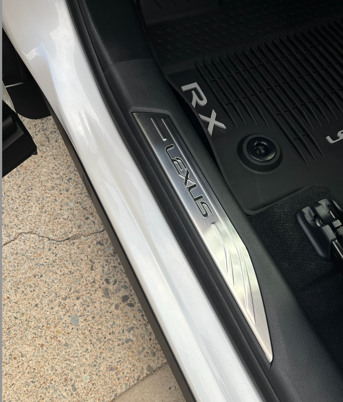

I did put one zip tie on the wire from the new door sill around the wiring group (black tube in last picture) before  clipping everything back together. It is daytime so cant see the lighting but it is working. Even in daytime the new door sill looks sharper.
