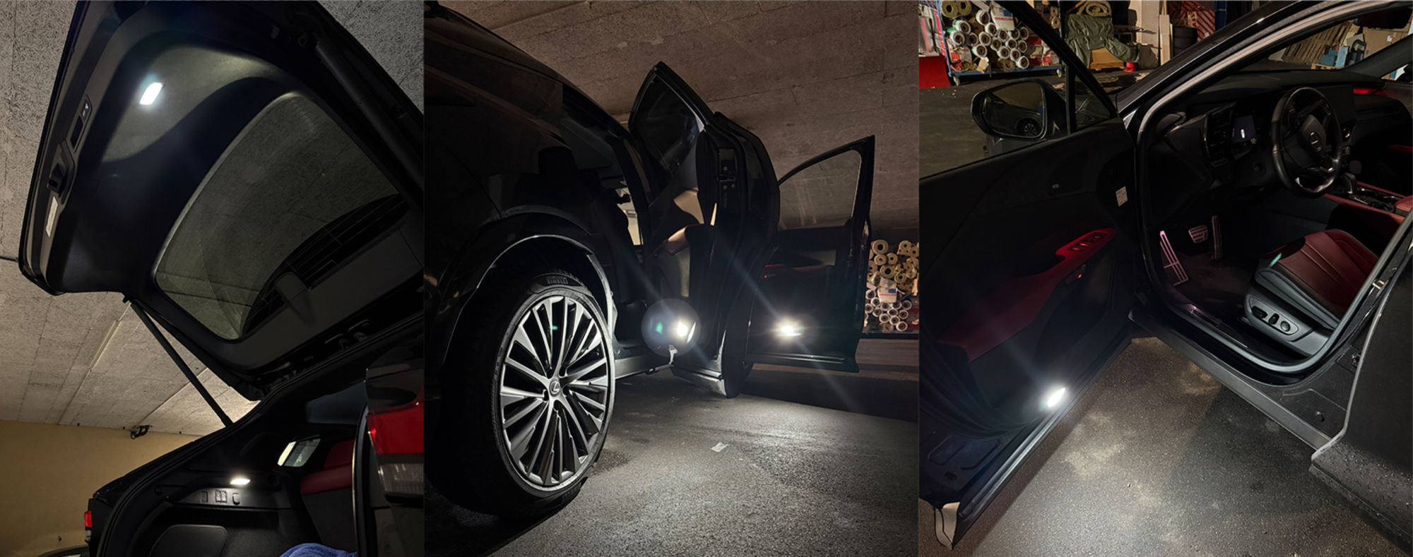

In the vehicle footwell, I haven't finished the LED project yet.
I replaced the LEDs in all four doors and the two LEDs in the trunk on the left and right. For the smoked-glass tinted LED in the trunk lid, I soldered in an LED panel. The housing was not available on the market, so I simply took the LED panel from the China Lexus panel and soldered it into the black housing.
You can buy the Aftermarket China Aliexpress LED´s (bright, yellow light, LEXUS Laser F-Sport Laser Module, etc.) for Toyota and Lexus up to 2022. The housing and operating voltage remain the same; only the connector has changed.
So, you order the China LED module, take the connector from the removed LEXUS OEM LED lamp, cut it off, and solder it onto the China Aliexpress LED module. You can simply pull out the electronic board with the weak stock LED.
