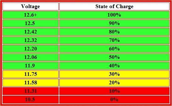

This is the SOC chart that I used to set up the ANCEL BM200. I used this chart when monitoring my sail boat and Airstream house batteries. You can use these values or others that you find on the internet, but I found these to be reasonable. They are easy to set up in the ANCEL software.
You can use a volt meter to monitor the 12 volt state of charge. Try not to let the battery get below 12.0-12.1 volts before charging.
When measuring the battery voltage it is really the "resting” voltage of the battery. (“rest" = no drain for several hours, the voltage at which the battery will stabilize.) that you want to measure — not after it has been recently charged. You will find that after charging the battery voltage will be higher than 12.6 volts, but after a period of rest it will drop closer to 12.6+ volts.

Try to not let the battery get below 12.0-12.1 volts. When measuring the battery voltage it is really the "resting” voltage of the battery. (“rest" = no drain for several hours, the voltage at which the battery will stabilize.) that you want to measure — not after it has been recently charged.
Yes, I've always maintained in this thread and in the NX thread that folks are unnecessarily getting worried about their "SoC" because their charger/monitor's "SoC from Voltage" lookup table was based on some historical ICE-based 12V subsystem/battery calibration, and not relevant directly for our Lexus (or any other modern) battery/design with a DC-DC converter and charging subsystem. As a result, people are furiously charging their 12 V battery even when when unnecessary and generally worrying more than necessary over a potentially dead battery situation. On reddit, I saw some self-professed expert lashing out based on their "that's how it always worked" outdated knowledge from ICE cars of 20 years past. So its great that you are helping bringing this realization to light for the community - that such a "lookup table" that needs to be customized in their battery monitor, to the exact battery and charging system of modern/hybrid/EV cars and charging subsystem.
