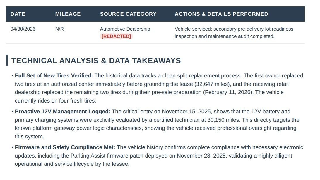

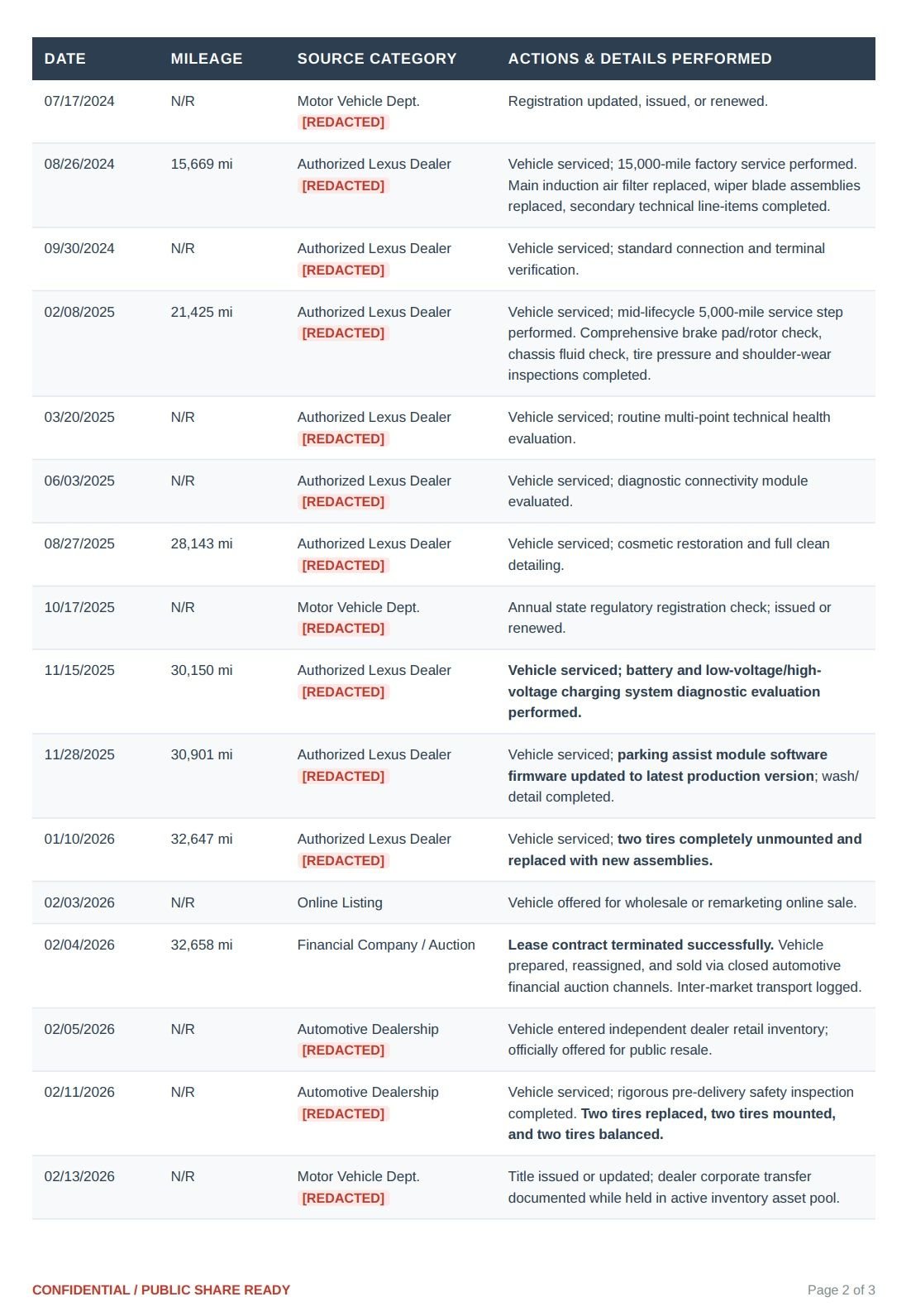

I joined this forum today because I was literally preparing to withdraw the cash to buy an off-lease 2023 Lexus RZ 450e Premium this afternoon. I am glad I stumbled upon this fantastic thread, which may have saved me from doing something stupid, because the Carfax service history looked strange (lacking service mileage and detail) or very frequent compared to how boring my Lexus ownership has been service wise.
I work from home now (maybe not forever) and wanted something to be there for local trips, and if we need to road trip we can take my wife's NX, but I also do not want a massive dead paperweight in there if I don't drive it for 2 weeks or more, which has me rethinking this Lexus EV thing entirely when I thought it was an obvious fit due to reliability and reputation.
The lack of detail in some of the service records almost looks like avoidance of a lemon law claim, or it at least shows me that my experience of visiting a Lexus dealer only twice on my wife's newest NX is not what I can expect with this RZ and that is a dealbreaker for me.
I am not married to the idea of owning this car, no emotion either way here, so tell me if you would avoid this vehicle or go ahead with it and try all suggestions here including the Ionic device on the battery...which, I don't know how I feel about all of it.
