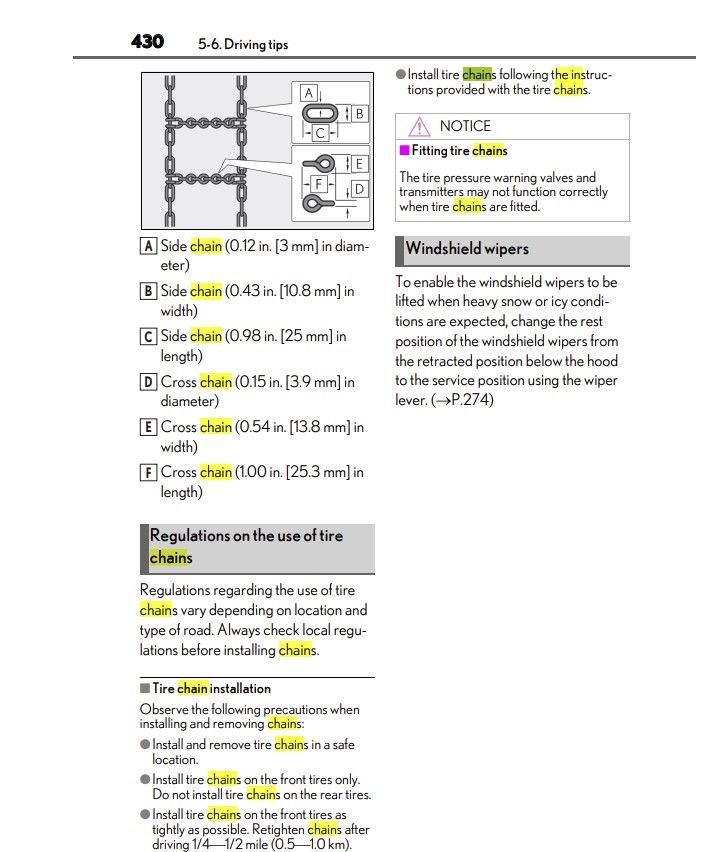

Old Nov 15, 2023 | 08:58 AM
WellsB's Avatar
WellsB
Joined: Oct 2023
Posts: 1,282
Likes: 1,073
I found this in the manuals for the RX. The image is from the 2024 RX450h+ manual, but the same information is in the other manuals.
Based on this, the SZ435 Super Z6 should be fine, as they only require 6.3 mm of clearance, where the chains in the manual would require at least 14mm of clearance or 15 mm to be safer.(Class S chains). The manual specifically states that chains are not to be installed on the rear tires.
2024 RX450+ Owners Manual P.430

I have a 2024 RX350h.
My dealer also made me sign a document stating that chains cannot be used on 21" rims... Verbally, however, they told me that 'cables' can be used. I haven't been able to find anything in the manual that forbids chains or distinguishes between 19" and 21" rims...
AFAICT, the RX350h comes in different tire sizes:
235/60R19 -> overall diameter 235*.60/25.4*2+19 = 30.10 "
235/50R21 -> overall diabeter 235*.50/25.4*2+21 = 30.25 "
i.e. they both have the same width but the 21" rims are overall larger by 0.15" or 3.8mm.
If the tire chains/cables fit in the dimensions prescribed in the manual (page 395 for 2024 RX350h), we should be good-to-go.

Considering that the RX450h+ only comes with 21" wheels and the manual describes chains that will fit it (front only) I have no doubt that 21s can be used with the right chains. I purchased a set of cables (make and model above) for a winter road trip, but did not require them, so I've not installed them yet.
