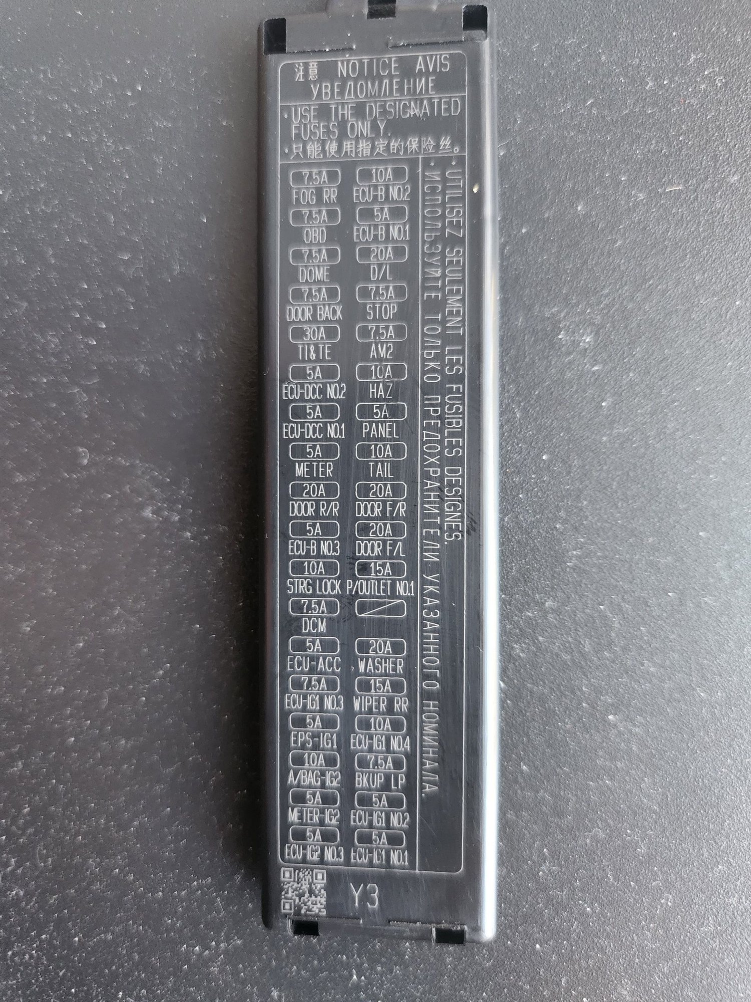

Here are the two fuse box lids with the fuse list. The fuse names might give you an idea of what is on the circuit.
Engine Compartment Fuse Box
Interior Fuse Box under drivers' side dash.

Thanks for the info. Unfortunately, aside from the obvious names on some of the fuses, I didn't see one addressing my 350's issue. Taking it in on Friday to have it looked at. One place suggested I simply pull every fuse from both fuse boxes to see what's blown. Don't have time for that one. My dealer service suggested it could be multiple fuses of some other part of the electrical system. Especially since some of the functions that are supposed to work with engine on or off work fine when the engine is on.
