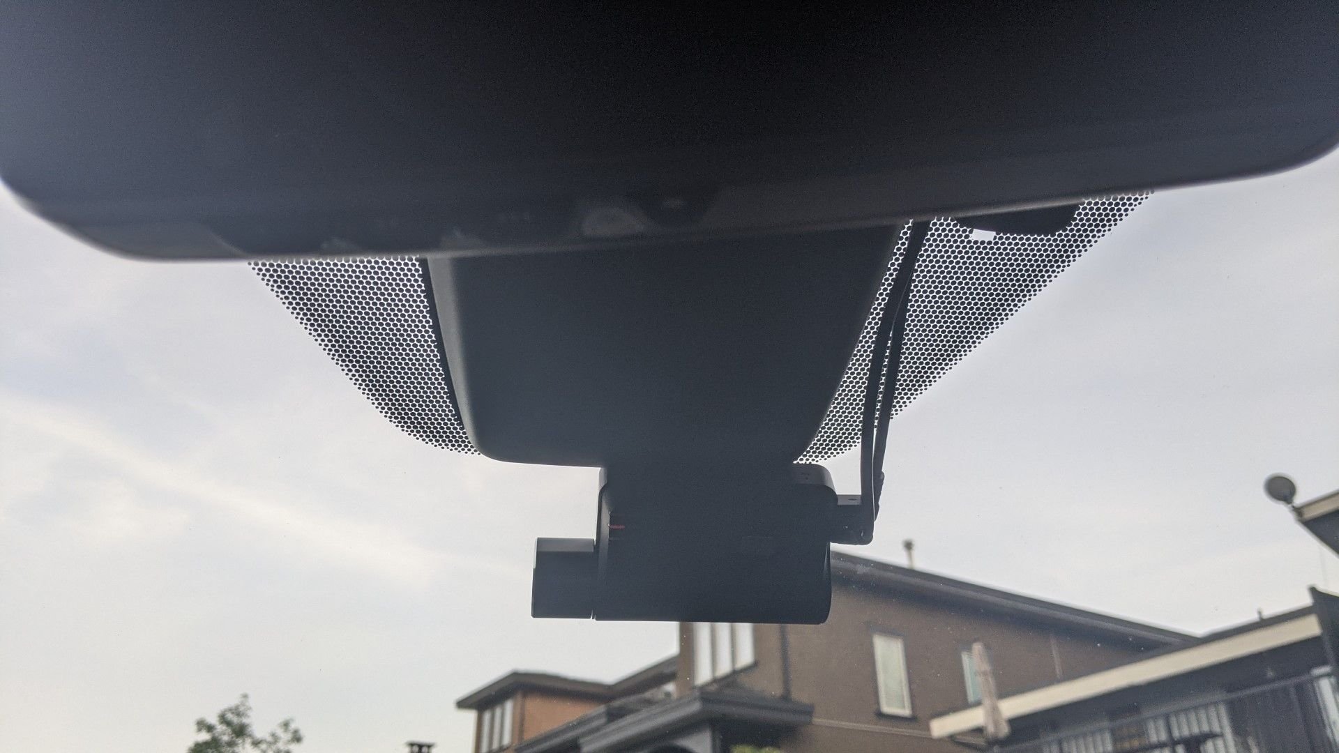

It's not a great photo, but it shows how I installed the front camera. It is a little too close to the top of the windshield, which makes it difficult to remove the SDHC card, so if I were doing it over, I would lower the camera about a quarter inch. But it's a very neat installation, with all the wiring tucked under the trim.

Thanks, @dibl . Good thought about the placement; I'll be sure to remember to account for both camera and SD card removal. I'm thinking about placing mine in the same position, but on the driver's side, so most of the camera is beneath the frit. I'm probably overly concerned about the camera being visible from the outside.
Do I remember reading that you ran the rear camera cable along the bottom trim, and not the headliner? If so, did you have any challenges getting the cable up to the headliner in the rear?

Yes, with offline pointers from another forum member, I ran the data cable through the biggest grommet on the rear hatch, angled it to go behind the airbag over the rear passenger-side seat to the C pillar, down the pillar underneath the plastic, and then under the kick plate or sill plate -- whatever it is. Under the B pillar plastic, under the the front passenger sill plate, and up under the A pillar plastic. Although I worried about the cable length when I first saw it, there was probably 2 extra feet that I had to coil behind the A pillar airbag. The trim over A pillar airbags were the toughest part of the job -- they have a hard plastic restraint link to keep them from becoming missiles when the airbag blows. That link has to be twisted, with needle nose or similar pliars, and held 90 degrees from its normal orientation while the trim piece is removed. You need to run all cables UNDER airbags. Then the plastic holder has to be twisted again to replace the trim piece. Also, be careful with the headliner in the rear -- it seems very fragile and I was warned not to pull it down except for the very edge where you need to insert your tool to pull the data cable. I used a long stiff wire, ran it from behind the rear passenger side door under the headliner to the top rear of the roof, and then taped the data cable end to the wire, and pulled it through.
That might be a superior result, if you can do it. I was intimidated by the prospect of getting my data cable neatly past the rearview mirror assembly.
