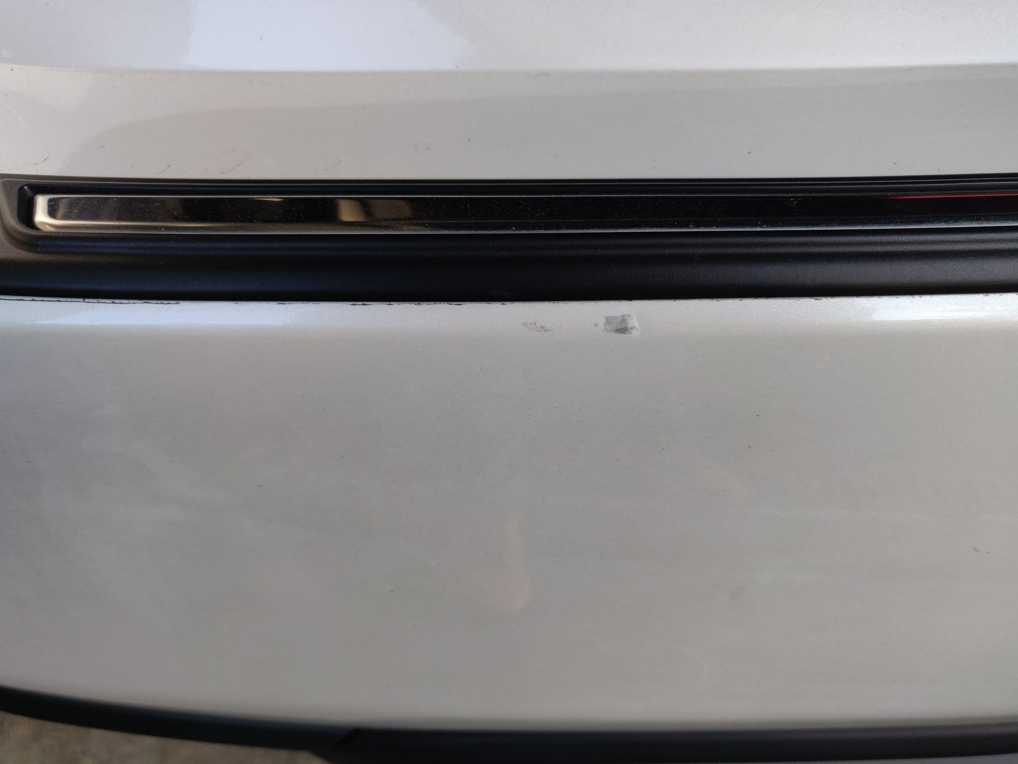

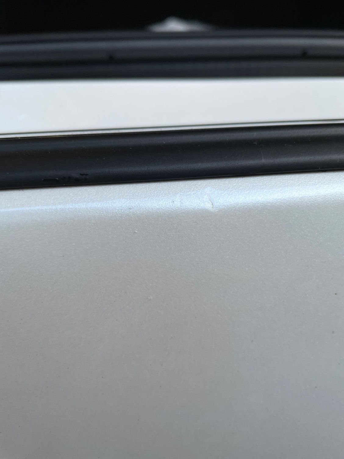

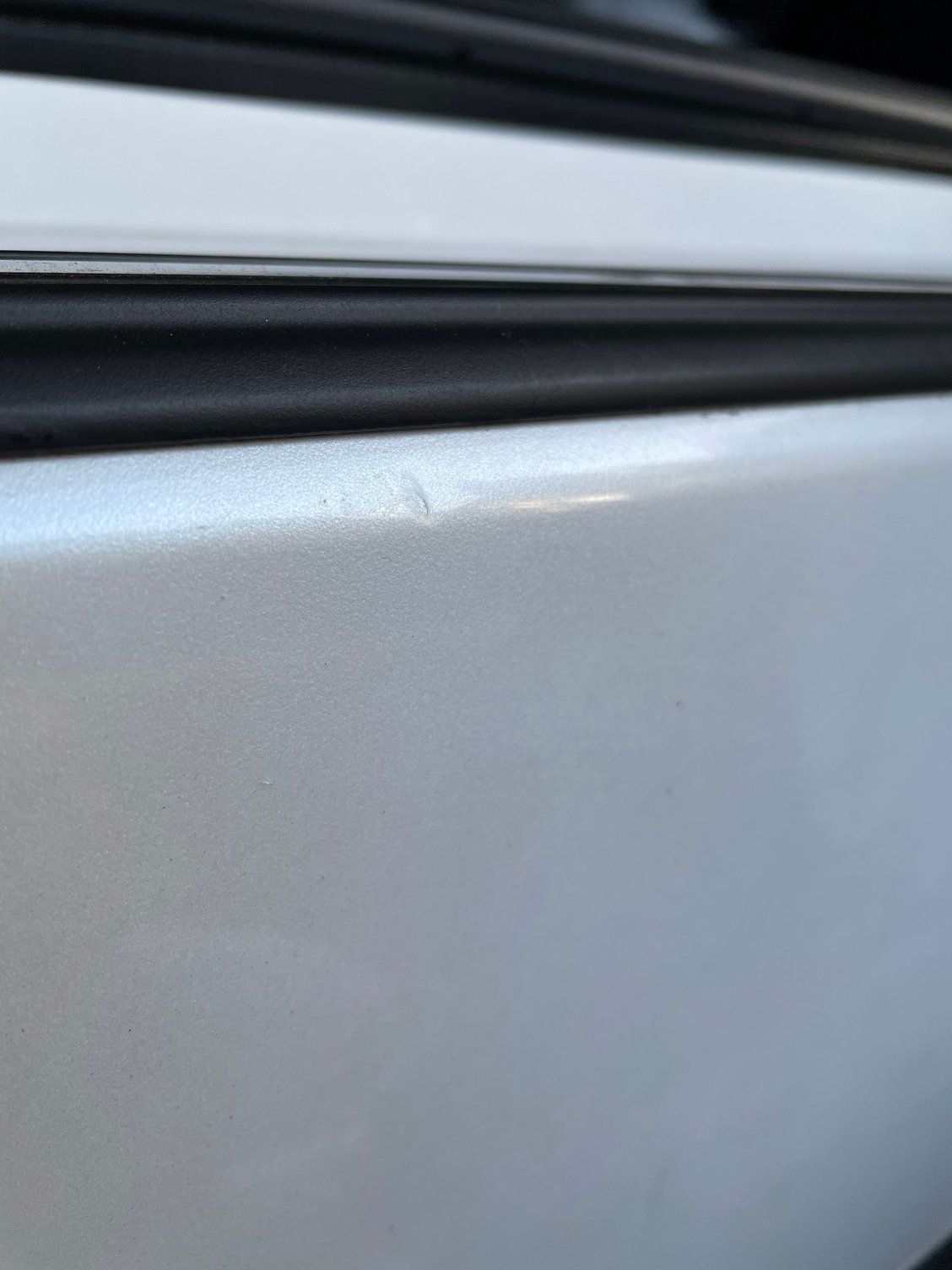

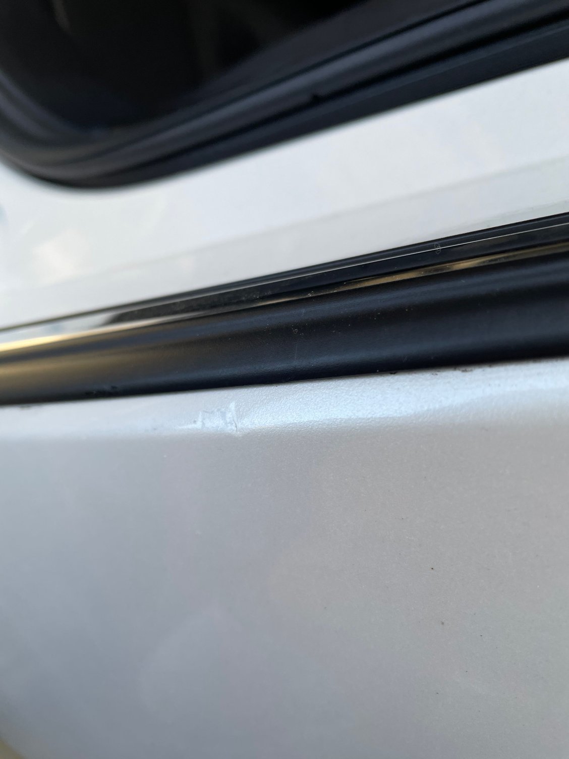

Dealership definitely scraped my bumper paint and left a dent when moving stuff around to access fuel pump in cargo area. Double check your bumper and car for damages after the repair, take pictures and videos before the repair at the dealership for evidence.
The repair was completed at Lexus of Bellevue
Changed fuel pump at around 15,000 miles with 25 miles left in the tank.
Dropped it off at 10:00am, got a call to pick it up at around 2:30pm. Received it will full tank of gas.
The car does feel a little more smooth when accelerating, maybe just placebo effect?
Received 2020 NX300H as the loaner
