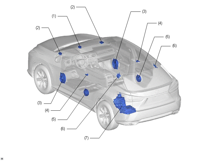

For our 2016 Lexus RX model, the Mark Levinson System features 15 speakers with the following impedance and rated input power:
- Front No. 3 Speaker Assembly (2 Speakers), Rate 8 O (6.5-9.7 O), 4 W
- Front No. 2 Speaker Assembly (4 Speakers), Rate 8 O (6.5-9.7 O), 4 W
- Front No. 1 Speaker Assembly (2 Speakers), 4.2-6.2 O, 9 W
- Rear No. 2 Speaker Assembly (2 Speakers), Rate 4 O, 0.5 W
- Rear Speaker Assembly (2 Speakers), 3.6-5.6 O, 18 W
- Quarter Side Speaker Assembly (2 Speakers), Rate 8 O (7-10.6 O), 4 W
- Rear No. 3 Speaker Assembly (1 Speaker), 3-5 O, 12.5 W

The wattage numbers don't seem to add up for the ML system when you consider the amp is much more powerful than stock.
Something isn't right.
1/2 W power rating?
