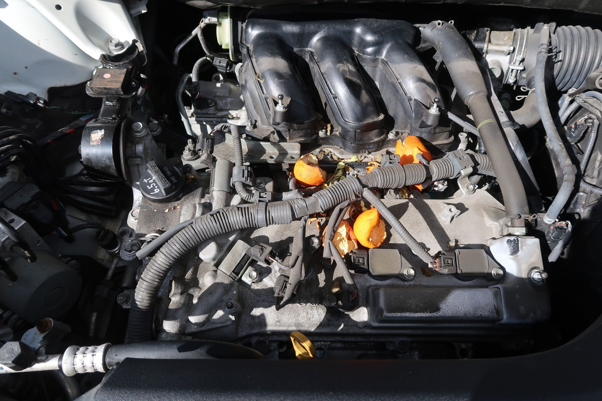

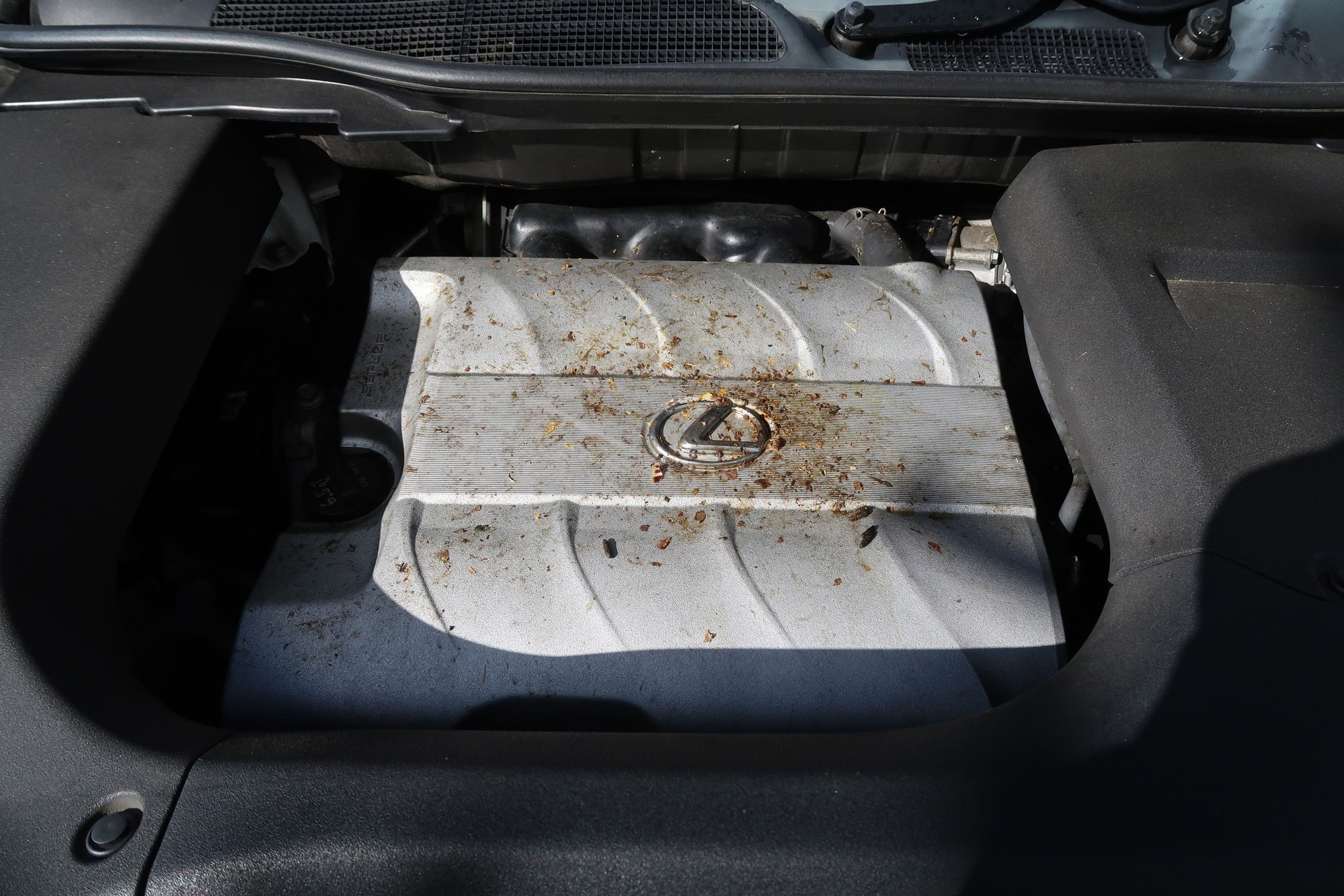

I was wondering about rats, we have a lot of them here, they eat oranges in the engine bays.
I didn't want to pull the engine covers in the rain for a "quick" visual inspection, which is easy on the Fords.
I forgot I had a ScanGauge mounted in another vehicle so after hooking it up to the RX it shows a P0304 - Misfire on #4.
I didn't know the firing order layout and found some drawings on Google.
Is #4 really the center cylinder in the front of the vehicle? Strange layout.
Yay!, Should be easy to check, I thought #4 would be in the back.

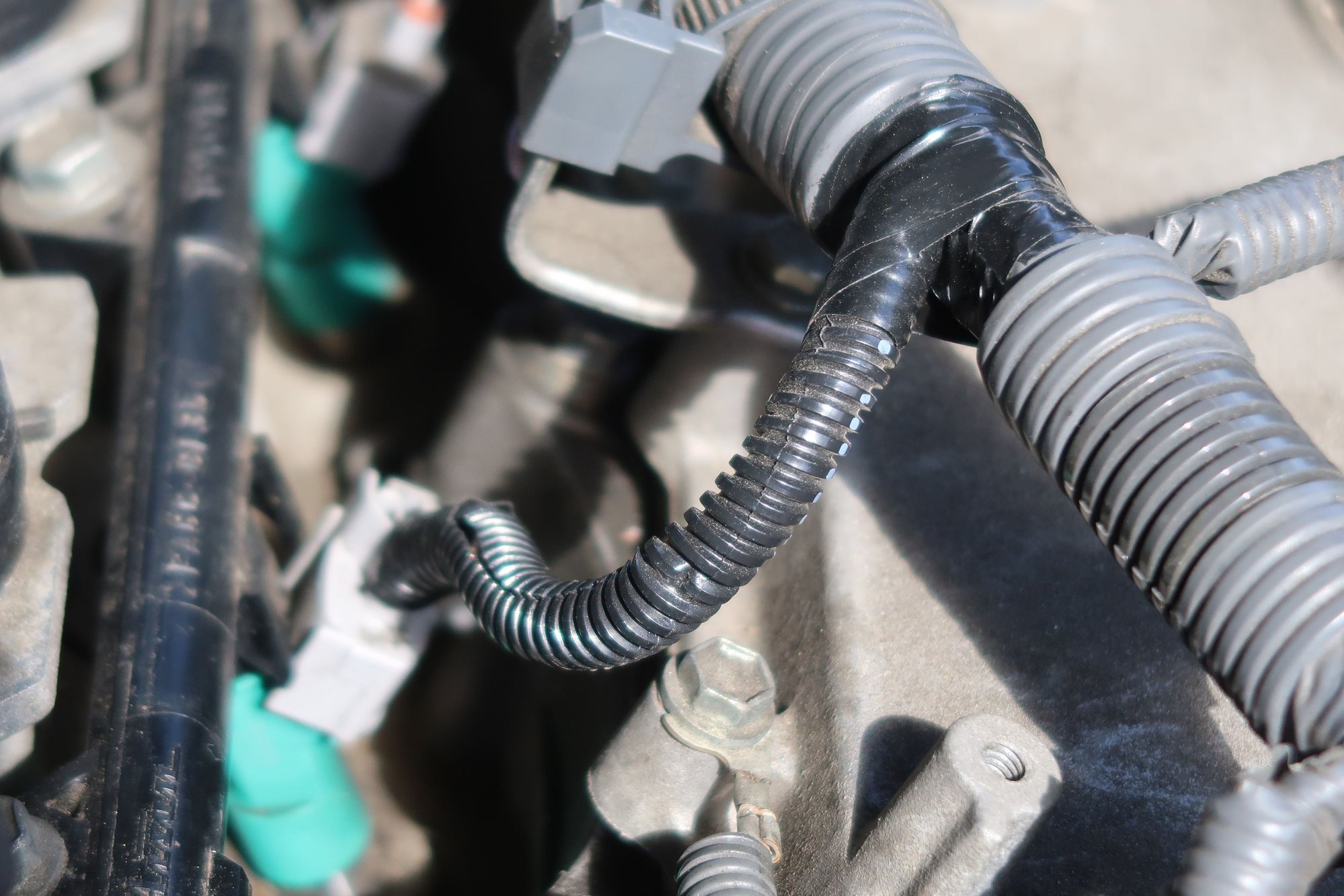

Found my problem.
Looks like the appetizer was escargot.
Followed by a main course of tangerines.
The #4 fuel injector was missing 2" of wire.
Repaired and running great, again.

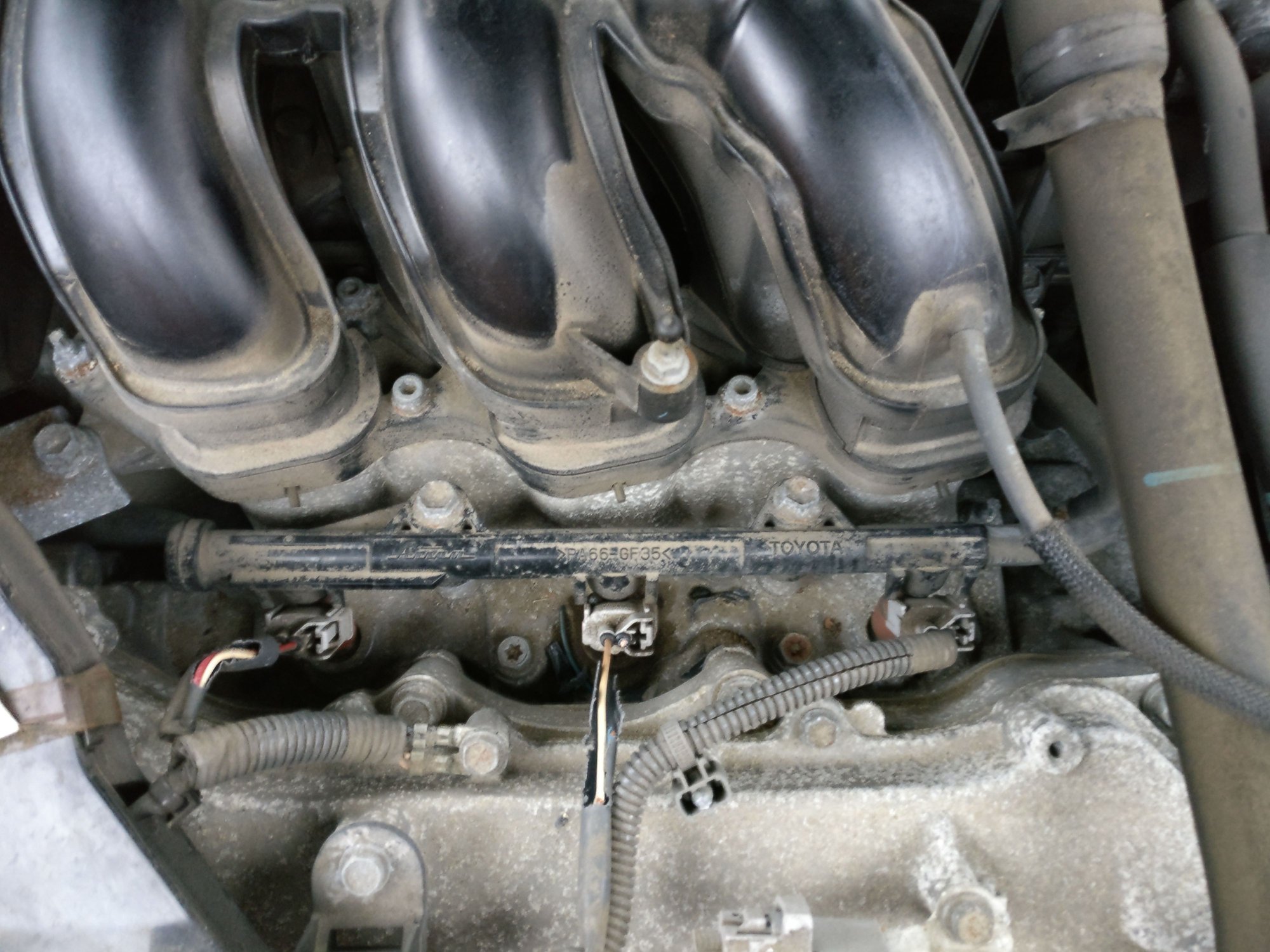

Same here on my 2010 Lexus Es350
#4 Injector connector was chewed
Ordered the pig tail to reconnect
and Rodent device for engine bay from Amazon - hope it works

2015 RX 350. Can you please provide the name ( or part no ) for this wire which is chewed by squirrel. ?
Respectfully,
Old Jan 6, 2021 | 04:04 PM
  #84
Mesquite77's Avatar
Mesquite77
Joined: Mar 2017
Posts: 617
Likes: 276
Intake air control valve assembly
