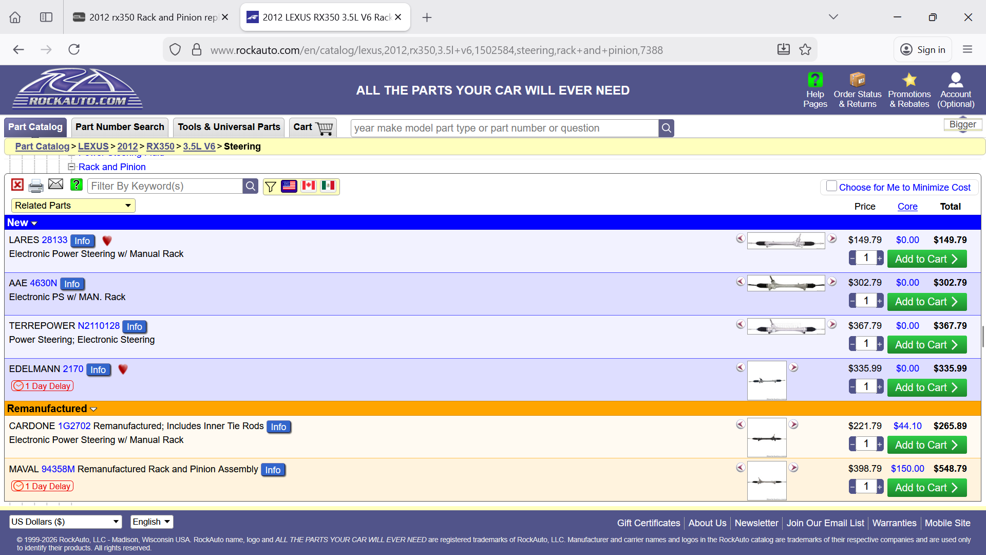

I currently have a rack and pinion that needs to be replaced on my 2012 RX350 with 78k Miles on it. I was checking rock auto and saw different options with hydraulic and manual being the difference between them. Has anyone replaced their rack and pinion from rock auto and if so kindly advise

The steering rack on the 2010-2015 RX350 is electric(or just mechanical) so it has no hydraulic lines.
The actual electric power assist steering motor is located under the steering column which connects to the rack.
I would assume that it is the manual rack option since it has no power assist by itself as that the rack need the electric motor to work.
The product descriptions are incorrect about these RX350 racks sold being hydraulic. The racks do not even have fluid lines on them in the pictures.

which one would you recommend for me to get?

I personally would go for the cheaper $150 option. However, I would swap the rack myself so no big deal if the rack fails a few years later.
If you are paying an repair shop to replace the rack then I would just go with a better quality(or brand name) rack like the Cardone remanufactured version. However, the best option would be a new OEM rack sold and installed at a dealership if you have the budget for that expense.
