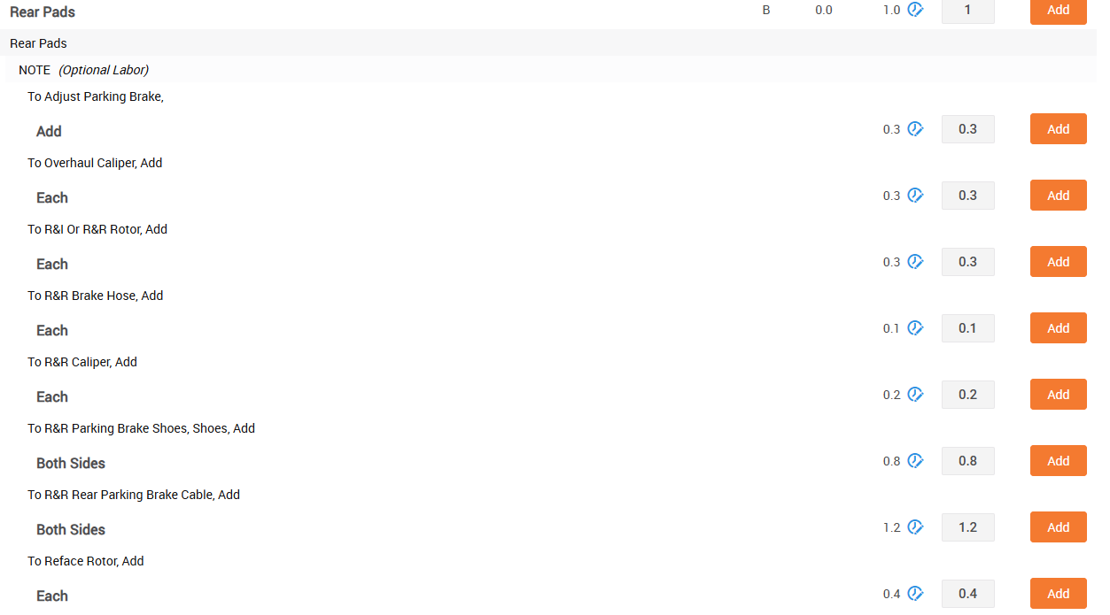

For folks who want to learn about billing:
Auto industry works on term "book hours" for the type of work for vehicle/yr/model [Some tasks are easy on some vehicles and some take more time]. Behind the scene the establishment holds back some amount and then pays the mechanic yet another. If the mechanic is fast and has honed his/her technique (s)he can do the job in less time [makes more $/hr] and if not an expert puts in the extra time out of his own time (makes less $/hr). The establishment uses the difference as profit after deducting operating-cost/warranty etc.
System then rounds up the book hours in 1/2hr increments.
Then the number is multiplied by the labor rate/hr. The labor rates depends on geographical area and establishment. Currently they range from $80 - $250 with exotics it is upwards of 500.

As I mentioned earlier, the cost of replacing a particular part is taken from the program. For example, an oil change takes 0.7 man-hours. One man-hour at this shop costs $175. Therefore, the total cost is 0.7 x 175 = $122.5.
Often, a mechanic is paid an hourly rate (for example, $20), regardless of the type of work he does or how quickly he does it (of course, if he works very slowly, he will simply be fired). I worked as a mechanic in various places, and in 3 out of 4 places I was paid an hourly rate.
