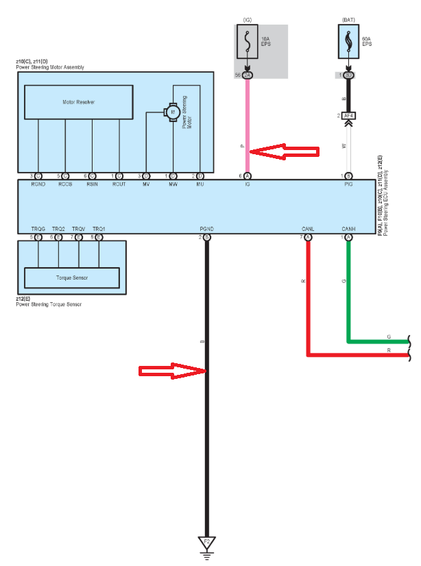

Find yourself another mechanic.
Have he/she test the power and ground circuit of the power steering ECU assembly. The technician needs to load the circuit and not just measure the voltages and check for voltage drop (red arrows).
Inflate tire pressure to proper level. For the heck of it, you can check the 10A EPS fuse.

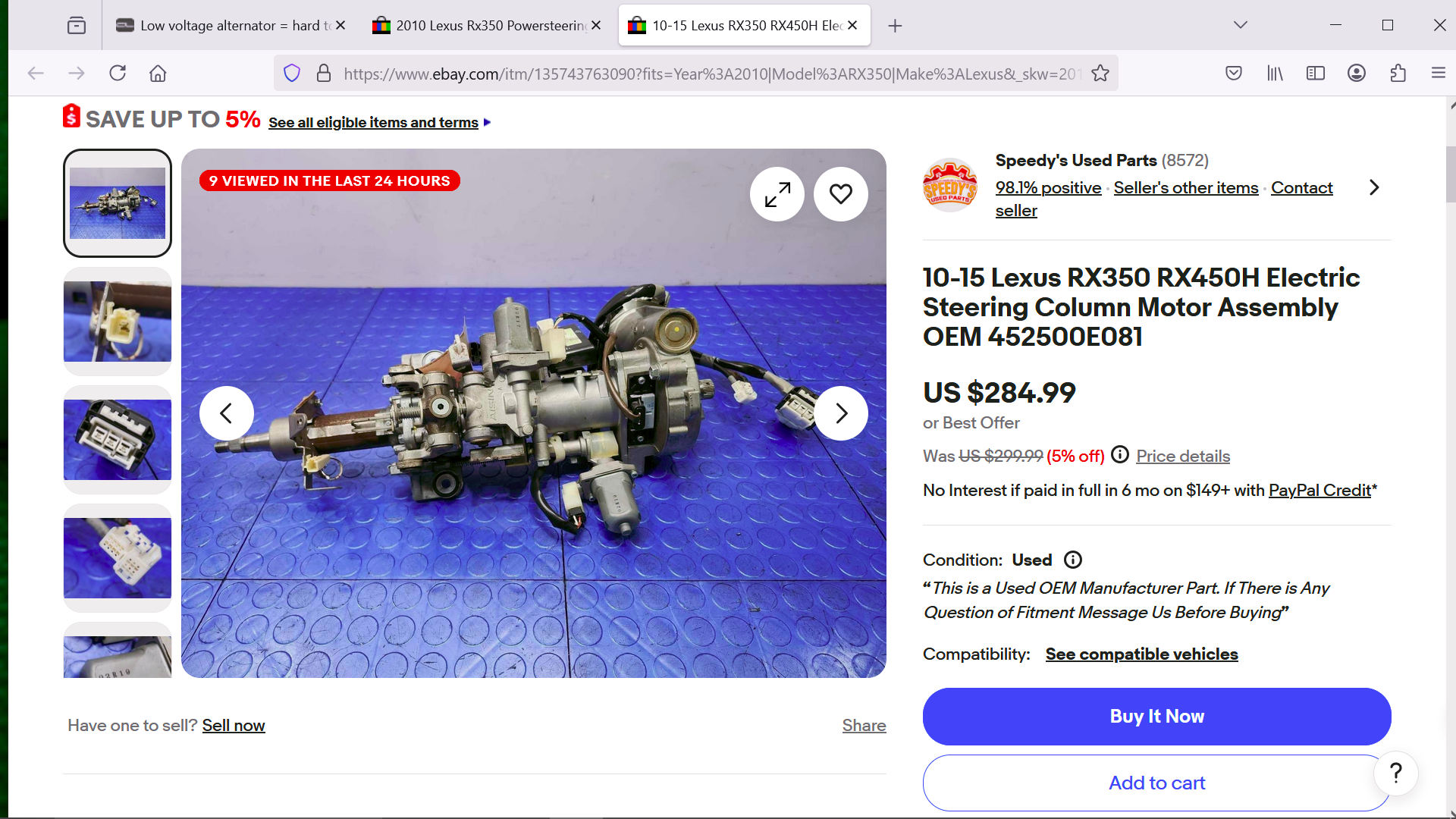

Well if the charging system and battery tested fine then you may have a bad motor in your electric steering rack. Finding an cheap capable mechanic that knows how to properly troubleshoot modern electric power-steering racks will be hard and end-up as a just replace the rack motor recommendation.
Heck even the Lexus dealer service shop will probably check the charging system and battery and if they are good then recommend a new electric power steering rack column motor as well most likely.
I would save up for a new electric power steering rack column motor.
Something like this
