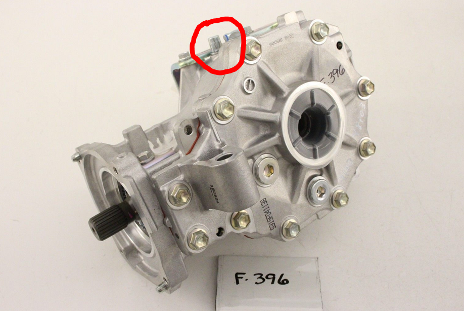

Just double checking , 2011 rx350 ( North America ) The breather valve on top of the rear differential, is that the pressed type or threaded . Looks like it's pressed to me. Anyway to change it , without dropping the Diff ? Thanks

It's leaking little oil on both side of the ax seals , when I was changing the fluid and took the drain plug , I heard air pressure release . So...I am guessing the valve is the problem , not releasing pressure and pushing the oil out...common problem.

I can't even seem to find the part number for it....it shows the threaded plug , but all the 2010 and up diffs I have seen , they have the pressed plug....

90930-03075 is the number
It's not a threaded one like on the older RXs, it's a push-in style one. I haven't done it on my 2014 RX, but it was easy to do on my 2008. Does not look fun to access on these newer ones

Thanks , that's what I ordered today . Yes, pain in the *** , you have to drop the diff. I just said *** it and made a small hole under the spare tire .10min job VS 10 hours hehe.
