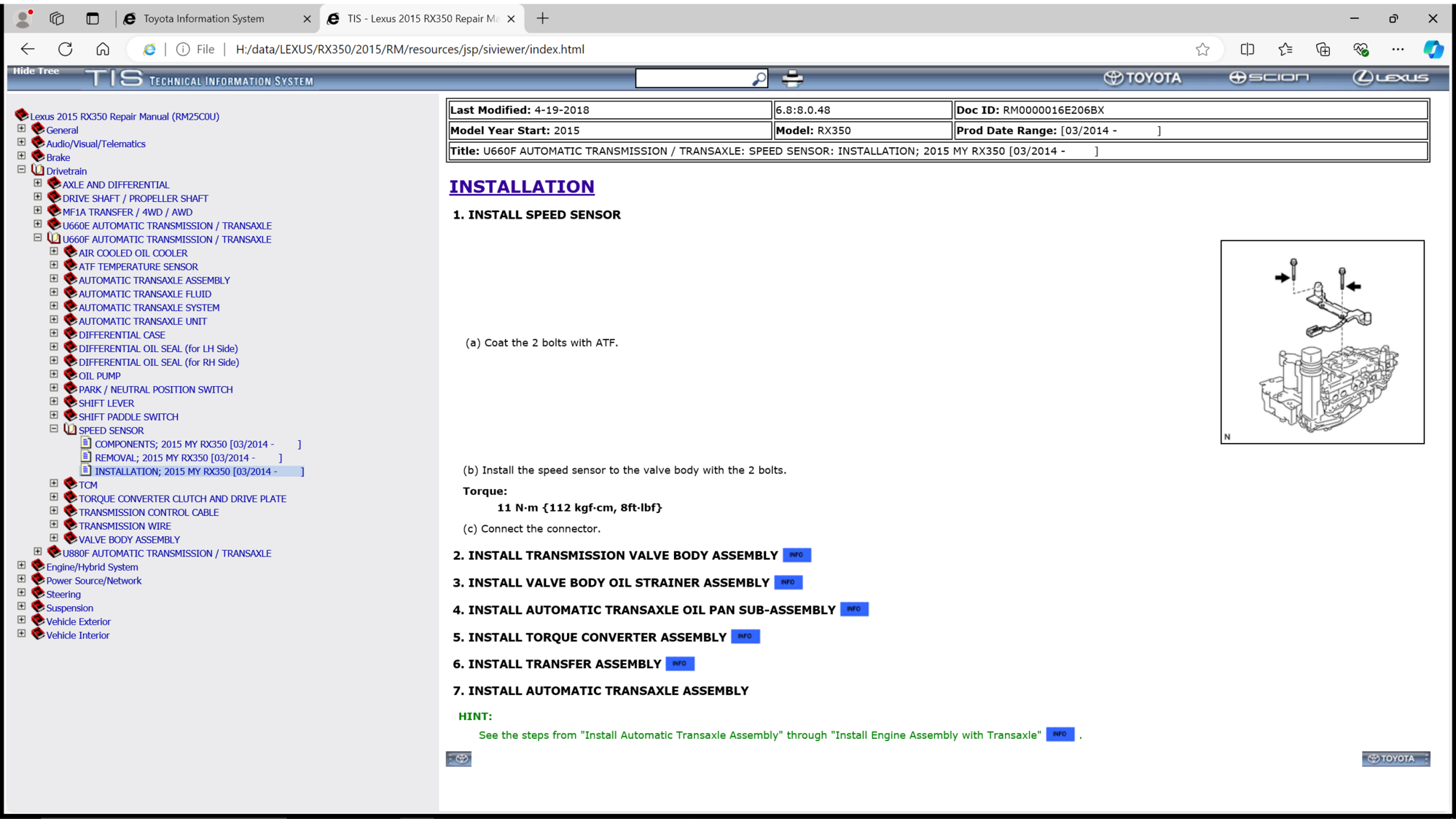

Here is how to replace the speed sensor. Not a hard DIY repair on the U660(E or F).

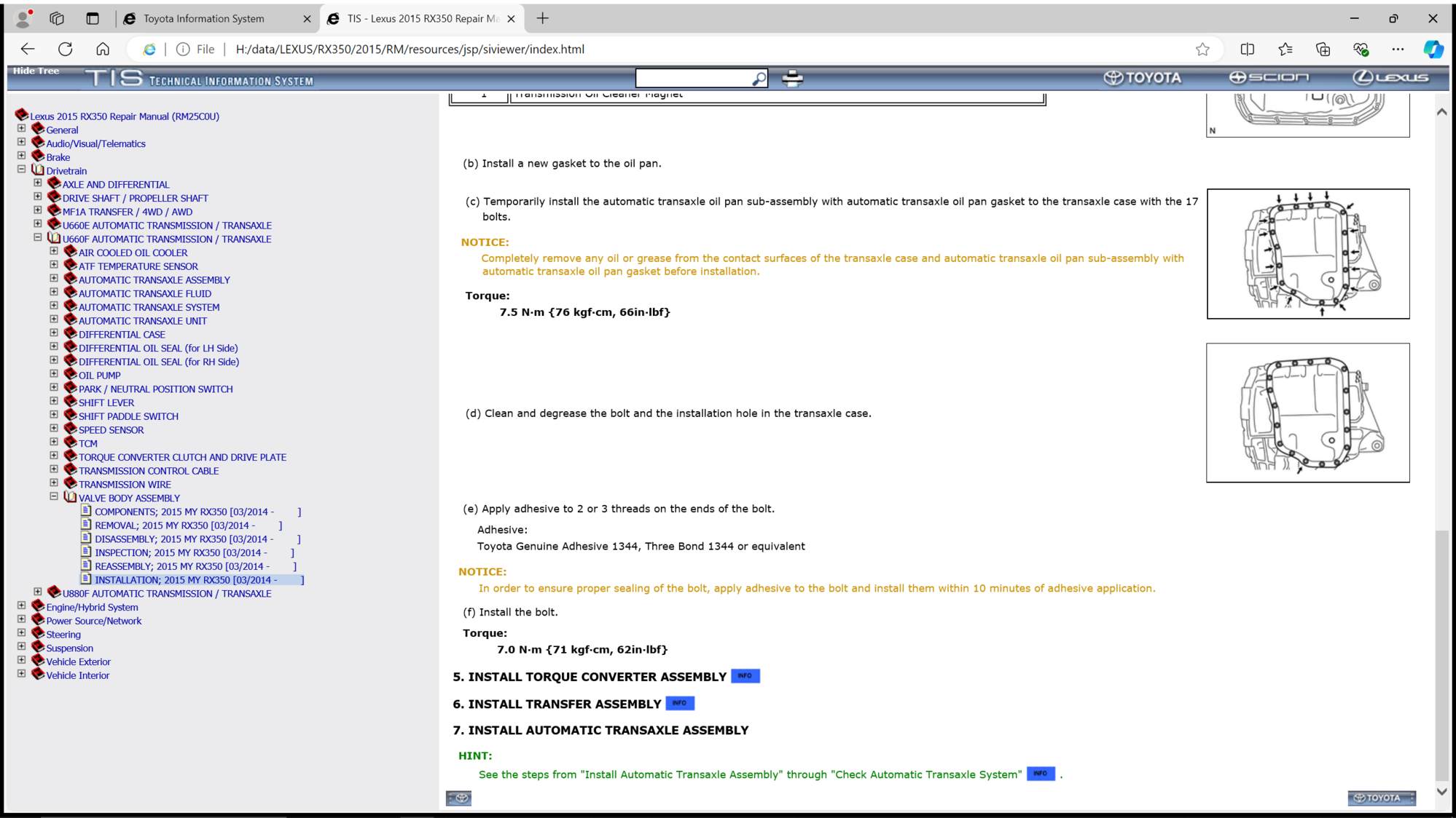

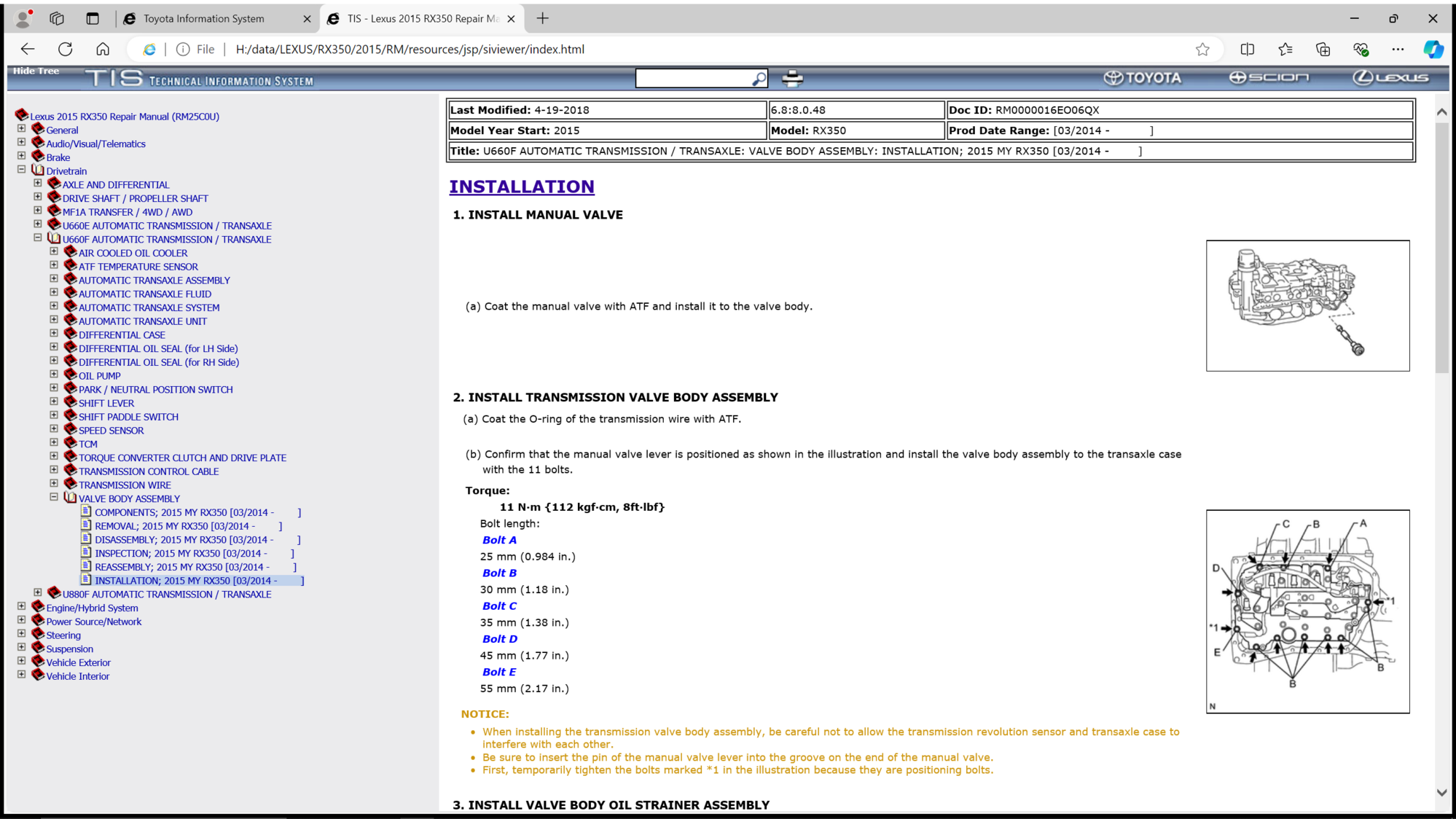

Originally Posted by afpj
@carguy75, thanks for that info! I don't suppose you have the assembly instructions with torque values for all the bolts to put it back together?
No problem.
Yes, I have the installation instructions as well.
