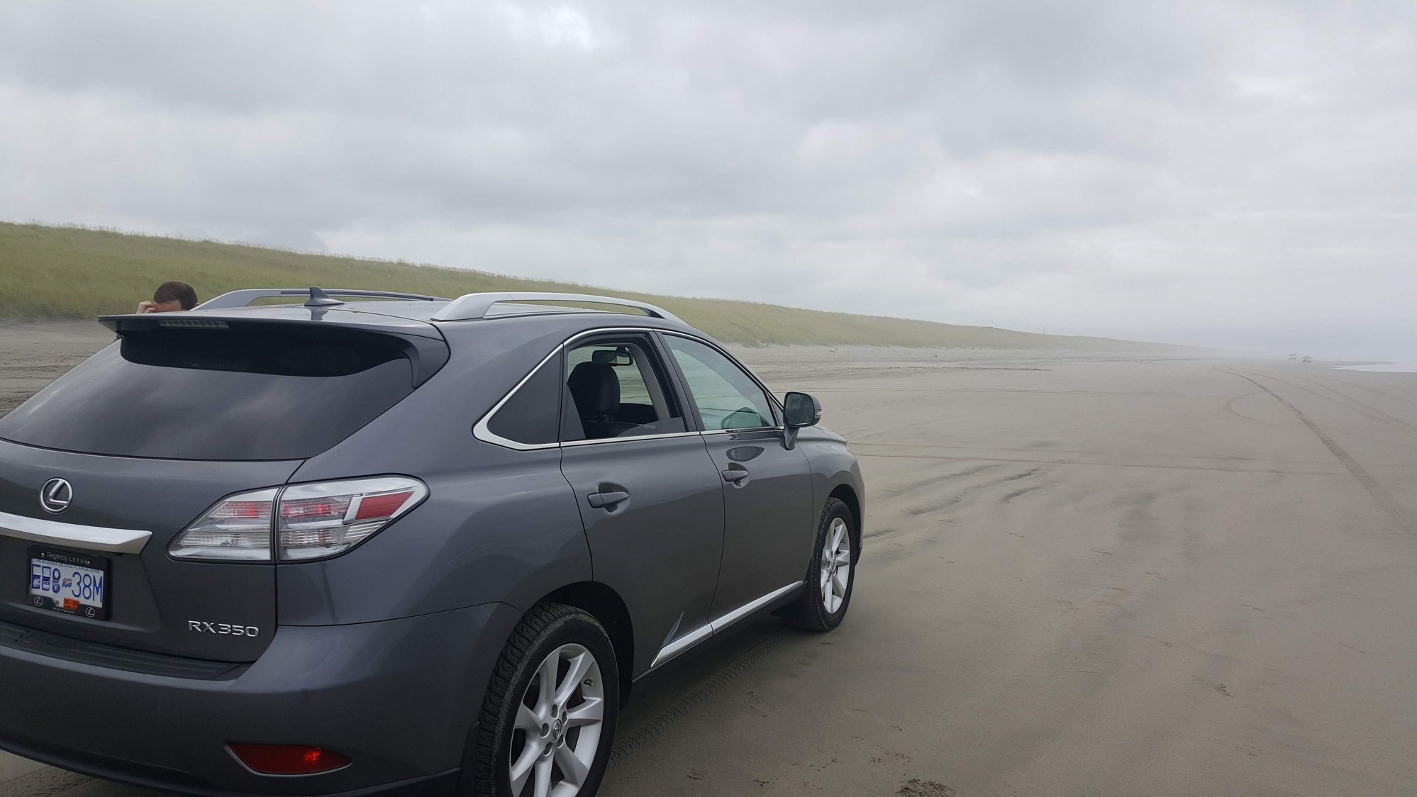

This was on the beach in Oregon with 255/50/19 all season tires. Getting onto the beach involved going through some deeper dry sand but got through it with enough speed. As shown in the picture, the sand underneath the vehicle at this point is damp and harder packed. I've since replaced those tires with 235/55/19 and have been back on this beach with no difficulty getting through the sand.
