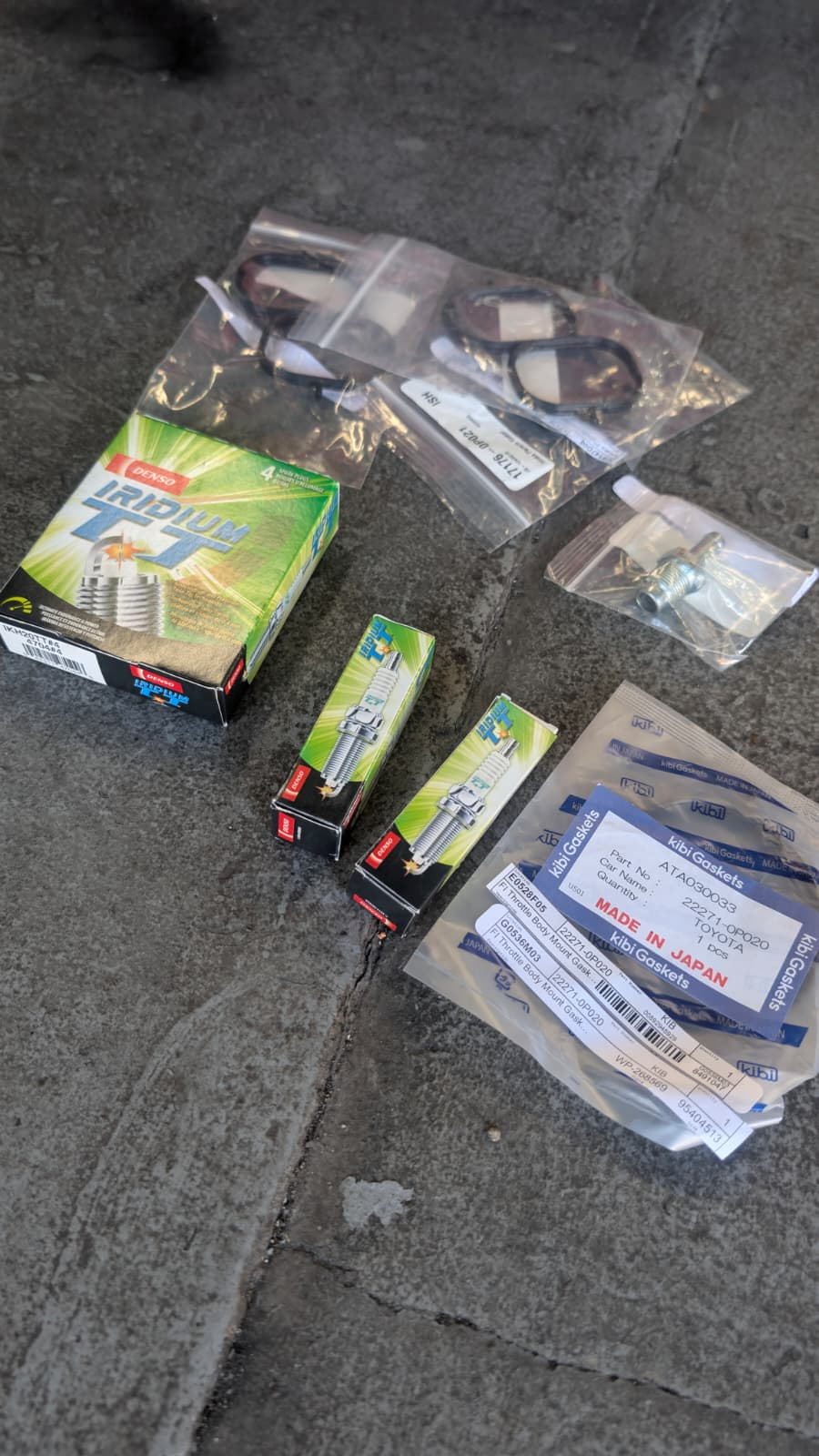

This is the kit I ordered. In my opinion, it's the best set, everything is made in Japan. It includes intake manifold gaskets, a throttle body gasket, a PCV valve, and spark plugs.

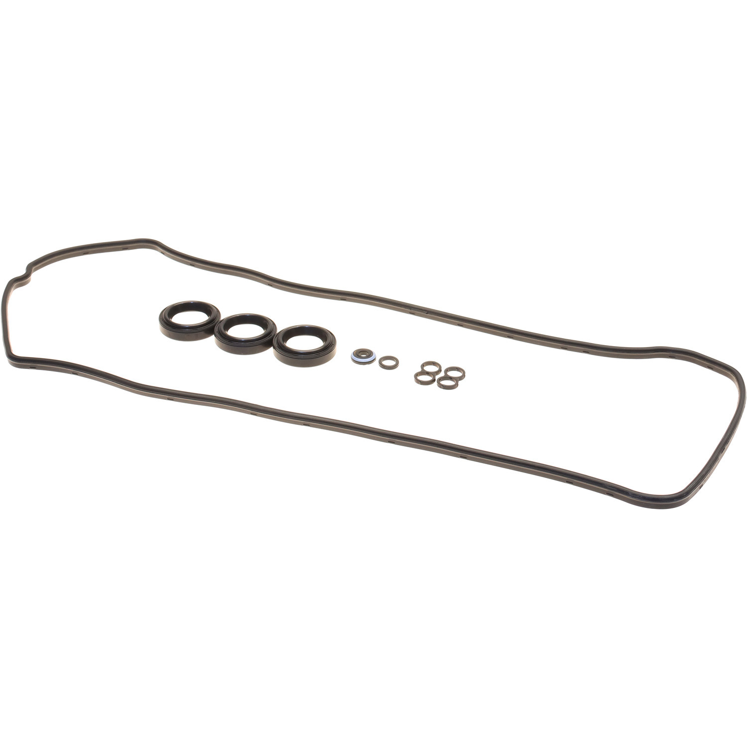

Optionally, you can add a valve cover gasket kit (gaskets, spark plug well seals, small O-rings).
I recommend Kibi. Made in Japan. OEM brand.
The left and right sides have different part numbers.
