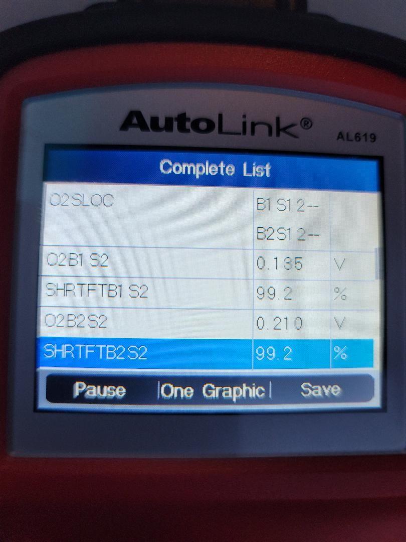

Thanks you guys for the response this is now kicking my *** and my neighbor but and he is an old school mechanic (45 years) and also stumped but he does state hes not too familiar with toyotas VVTI engine models
so far still have the generic 0304 code even after changing plug coil, AND new injector oem densos
compression on cyclinder 4 (middle front is about 18-24 psi ) less than the other 2
my neighbor attempted to pressurize the cylinder (4) with regular air to hear if there's a leak and hes confused since at TDC all valves should be off but he hears air leaking onto the other cylinders?? but cylinder 2 and 4 have compression ??? he wanted to hear if air escaped thru the exhaust side out the tail pipe but was stumped so he would try with a similar engine at his shop
so i am left at the last step the harness going to that cylinder either the last several inches exiting ontop of the engine or should i change the entire harness since if its that the issue it may pop up at other cylinders?? who has an entire harness (not from junk yard)
this damn car is in near immaculate condition that i would hate to junk her due to a weird misfire with only 78k miles
i dont think i captured the correct live readings from my scanner but these readings look crazy also lol

So, -14 perc bank 2 LTFT is consistent with the problem, the sensors are seeing too much fuel and are trying to lean it due to poor combustion on the bank. May have a burned valve, explains leak on air compression test? Removing head is big job, I would scope the electrical connections next. BTW, it is not terrible hard, but tedious, job to drop subframe with engine and trany to pull the head. My 2008 was perfect except it broke a valve spring, did the job in my garage, during covid.

Yeah i agree with Mesquite, these fuel trims are way off and what's worse is they are running way positive on one bank and way negative on the other bank which is unusual.
My apoligies friend as I see you are a DIY guy but you tried the easy stuff and if the head gasket check doesn't work you will need someone at dealer level diagnostic experience to figure it out. Might cost a couple hundred to figure it out and worth it- don't let anyone tear your engine down without a dealer level diagnosis first.
