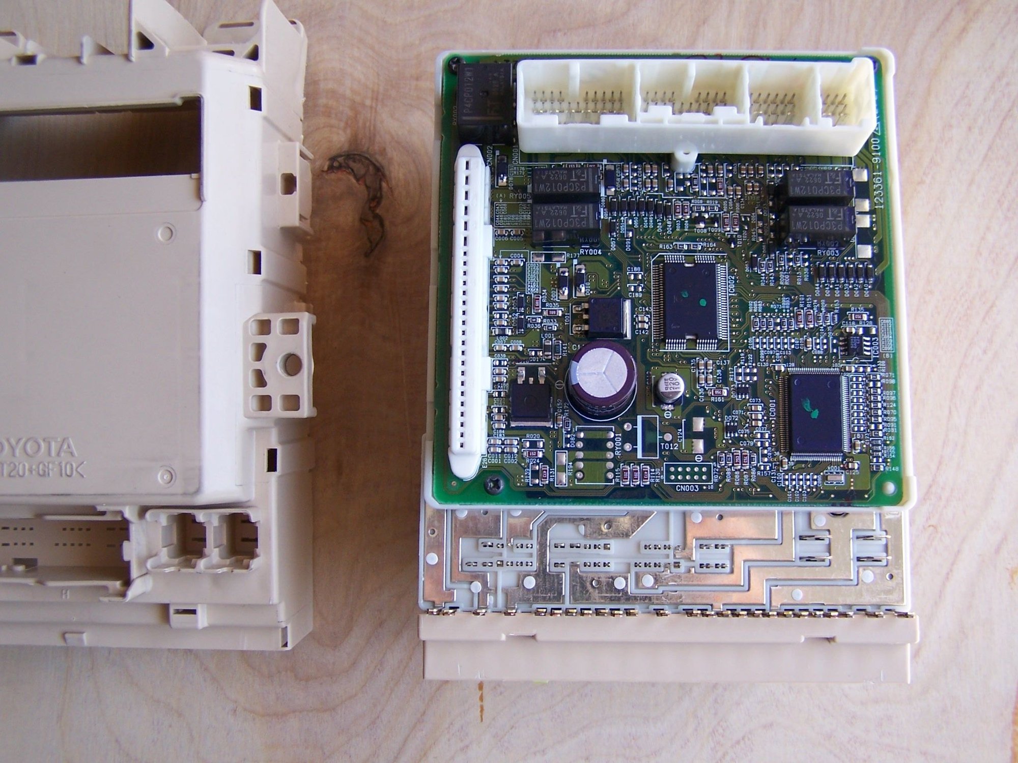

When I changed my dashboard junction block, I ended up changing the body control module also as it is part of the junction block assembly. My car is a 2007 and the donor car was a 2008 or 9. I have not had any problems from having a BCM from a different year. I did have the service engine light on, but it reset using the normal method.
If you want, I'll send you the BCM printed circuit board from the complete junction block I took out of my car. However, there are 2 cautions. My car was assembled in Canada and the complete junction block assemblies are different for Japan and Canada cars, so if the VIN on your car starts with a 2, you can use it, Other caution is that the junction block is different for whether you have heated seats or not. My car does not have heated seats. I think the difference is a jumper in the actual junction block section, not a BCM difference.
back side of junction block, BCM under this cover
back cover removed showing the BCM printed circuit board
BCM removed from the junction block. it just pulls off.

thats what im thinking; so if i replace the bcm it will have to be reprogrammed wouldnt it? also i highly doubt that the board from your rx would work as mine is a japan built version as the vin starts w j
