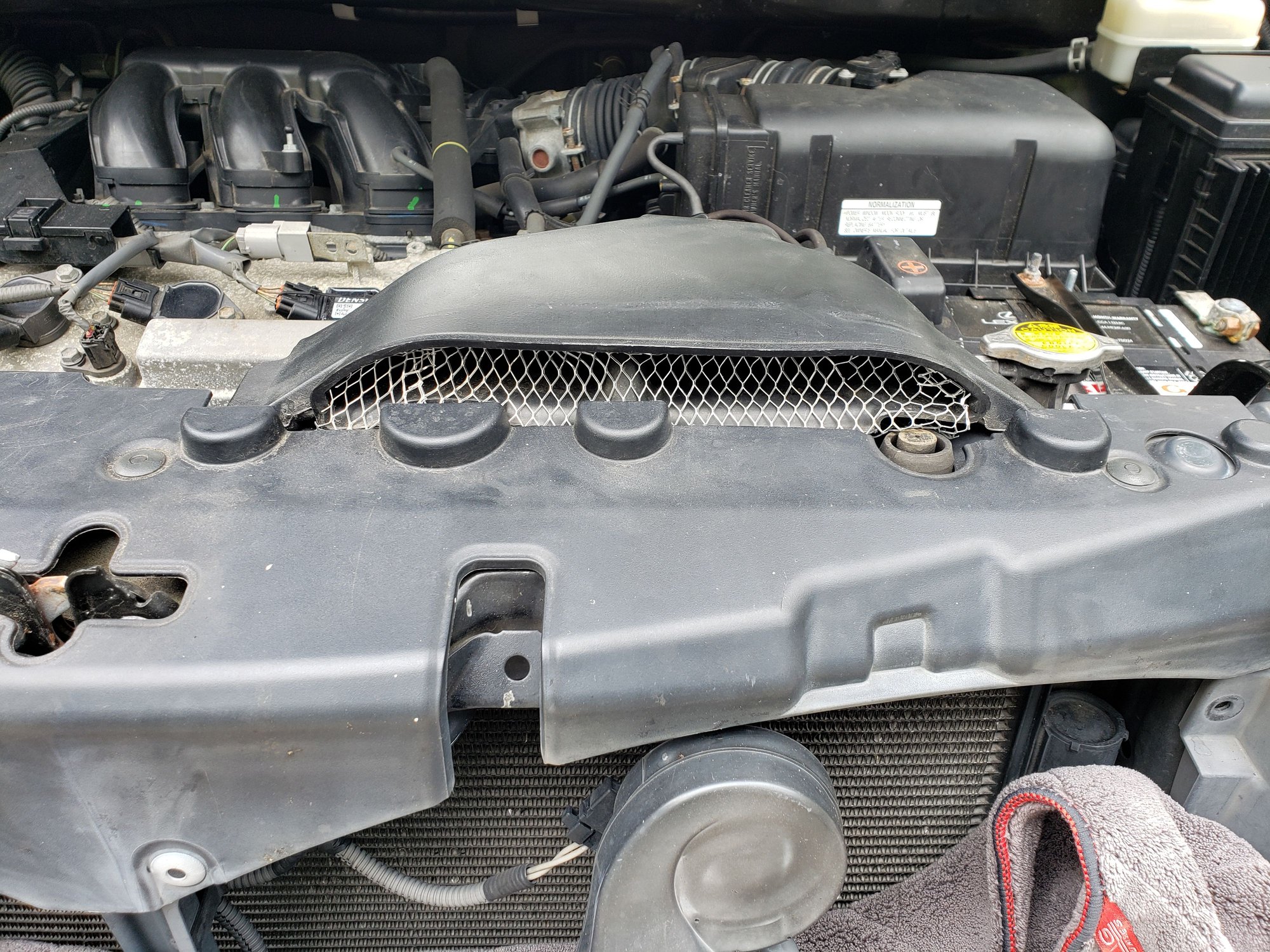

I got crafty yesterday and attached some wire mesh over the intake openings. The hardest part was removing the wiper arms. I ended up buying a removal tool and using a rubber hammer to pop them loose.
Dirty!
This is a flexible wire mesh from any big box home improvement store. Wire snips make it easy-peasey.
I used a few sheet metal screws after pre-drilling pilot holes.
I went ahead and did the engine intake while I was at it. Our Honda had a pile of acorns on top of the intake filter recently, so I did this same thing to it.

Looks like he has replaced an Ignition Coil, much like the one I used on mine, a direct replacement, cylinder # 3.
