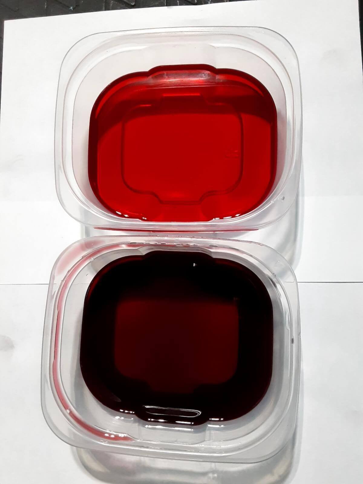

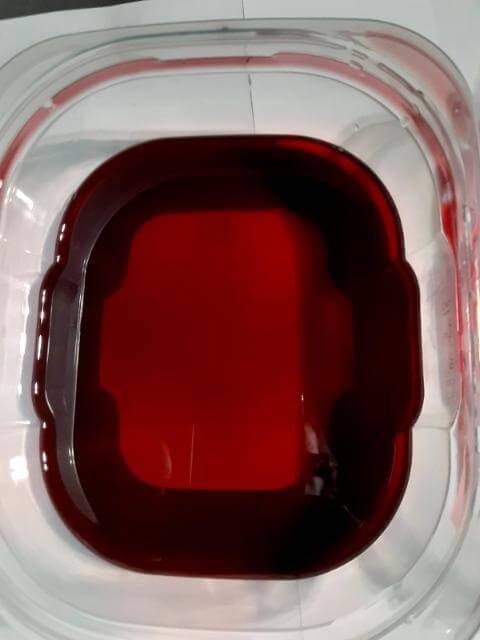

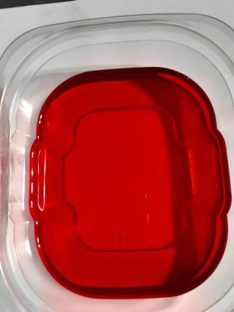

Hi members, ordered a case of Toyota Transmission fluid and been putting the service off for months.
Got the car at around 120k miles and at approx 140k I dropped the pan and changed the fluid and didn't think it looked that bad however it needed it.
Recently at 155k miles I decided to do a quickie drain and fill(4 quarts).
While loosening up the drain plug, the fluid ran down my arm and dripping off my elbow glistening in the sunlight it was looking very red. lol
I was happy with the color from what I saw but thought I should drain a little in a clear bowl and compare to new fluid to make sure.
Ya'll be the judge!

That fluild looks great.......All the trucks & cars that I've had, I've always pulled the pan, cleaned the magnet(s) as well as swap out the filter ever 30K, the stick cars I went about 100k or so.

Looks good enough to drink! Probably smells nice, too.
So that's 15K miles after you dropped the pan? Looks good with a normal slight darkening.

Ya'll really think so?
Honestly I was hoping for a little bit better when I compared the old to new so that's why I wanted to see what ya'll think.

Keep up on the basic maintence & you won't have to swap out shift solenoids, as they were messed up thanx to the friction plate debris via the lack of changing the trans fluid & filter.....Clutch plates, frictions, bands, bushings are wear items which'll play havac on the solenoild pistons & bores tight torerances.....as well as the fluid heat. Auto trans fluid has a lot of work to do, so regular fluid & filter changes go a long way as well as cleaning the pan magnets......

I don't think it takes long at all for transmission fluid to darken and lose it new smell. I'm no petroleum engineer, but these fluids go through chemical changes during heat cycles. It's normal.
(And I see Felix mentioned the heat, too.)
You can always change the filter. I think I saw a video on youtube of someone "flushing" the solenoid valves when he dropped the pan in his Toyota.
