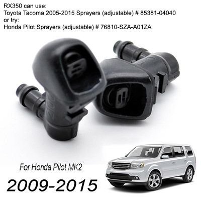

If you're going to replace the sprayers, you might as well get adjustable ones. Here are two options:
