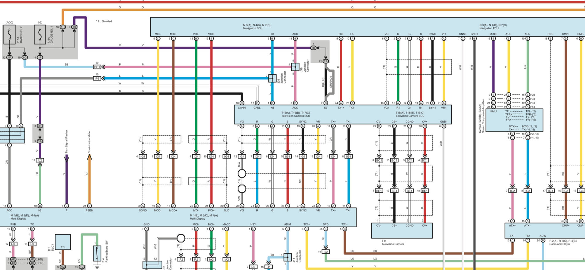

here is the camera wiring diagram for a 2007 RX. It does not show any controller for the camera. It shows the CANBUS being connected to the display unit/
I'm guessing here, but since the 2nd generation RX has the original style steering using a pump and hydraulic fluid, it may not have any sensors to feed the navigation display with the car's angle. Starting in 2010, the 3rd gen RX has electric servo steering, so it has sensors that can feed the navigation screen with the car's position.

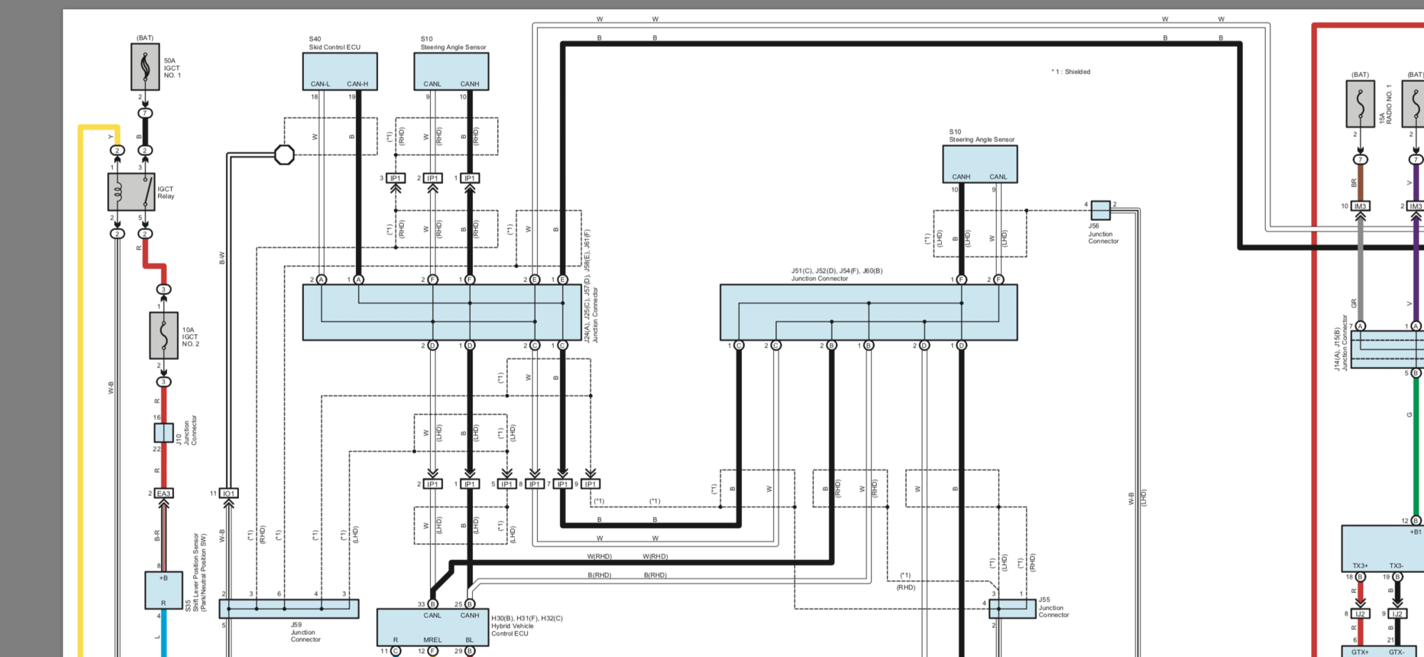

My turn to guess - I suspect that’s from a Gen 5 nav 400h. I’ve attached the diagram I’ve seen for 06/07’s, which seemed to me to have pinouts consistent with Gen4 nav units. You can see the CANH/CANL connection which goes to a junction with like 8 things wired in (all of which are on a separate CANBUS diagram). You are correct though, the camera / park assist controller only lists as compatible on the 06 and some 07 400’s per Toyota.
