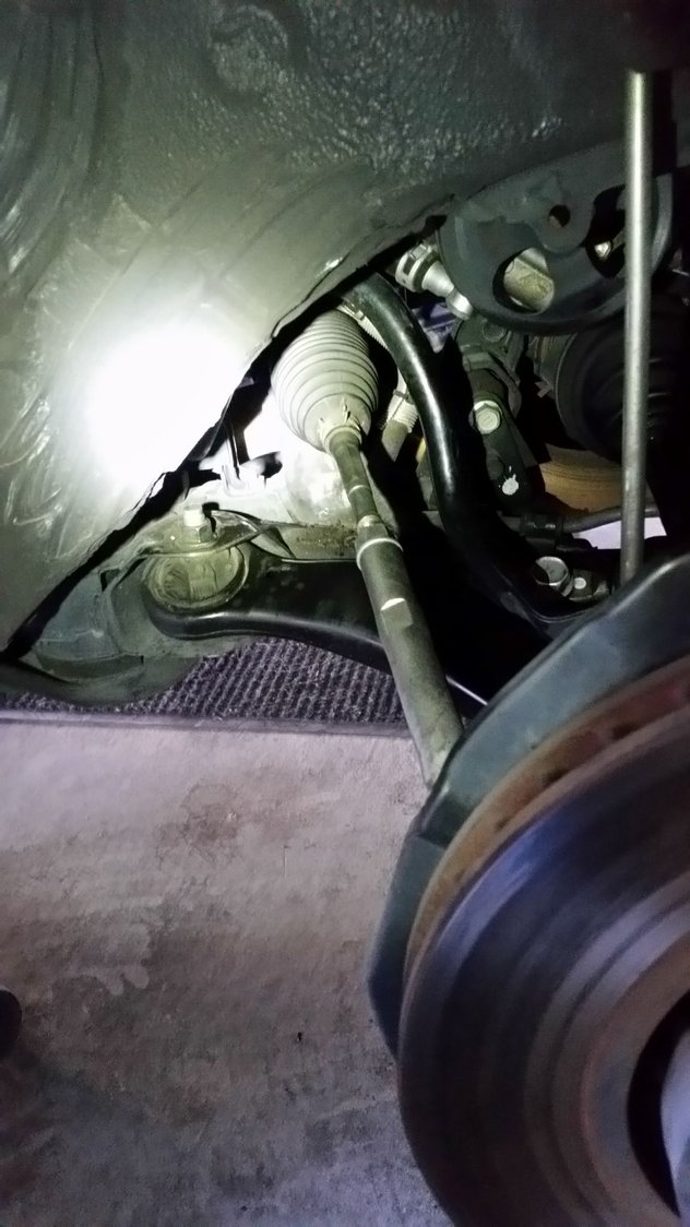

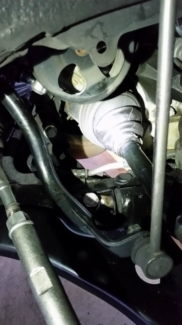

So on to my problem, recently my 09 rx350 has been making a intermittent grinding noise while coming to a stop. It happens at about 20mph and slower. It makes a really loud constant grinding noise if I hit the brakes fairly hard, it's sounds and feels scary. Almost feels and sounds like small rock's or gravel got in between the rotors and pads. I checked the half shafts and the passenger side doesnt have any tears but there is grease creeping out from the smaller of the two clamps. The drivers side was dry as a bone. I recently did the brake pads and resurfaced the rotor's, I checked the passenger side but not the drivers side yet. Any ideas or comments would be greatly appreciated. Also I found the passenger side rack and pinion boot tore I'll try to include a pic.
