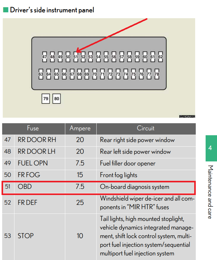

First steps, please check the 7.5A OBD fuse on your vehicle's left footwell kick panel to see if it has been blown. If the fuse is OK, then go to the next step
Check to see if the OBD connector's pins have lost their tension and/or got pushed back. I have attached few videos for you. HTH!

I can't even find the fuse panel in the left footwell. Dumb-de-dumb dumb.

Originally Posted by tammap
@Joyous56 , now lay in your back and look under the dash, HERE. 😃
Why they made it so hard, I don't know. Lol
But, that's where the OBD port is.
Ps, after you can see it and know where it is you can then feel for it with your fingers next time you want to plug in, without going under there.
Hint: the plug is polarized(only goes in one way), meaning if the scanner plug won't plug in, flip the plug over and try again.

I'd be a issue, if the 7.5 amp is pulled/missing from the #5 spot.

Any clues about why or how the OBD might stop communicating? >>>(If the fuse is removed or blown from the #5 slot under the dash it wouldn't get power to read a OBD reader)I took the car to Advance Auto, and they told me that unless the check engine light was on, they couldn't check the OBD. Don't know if that's generally true, or just a limitation of Advance Auto. Thanks for any insights from anyone.
