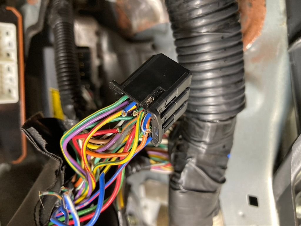

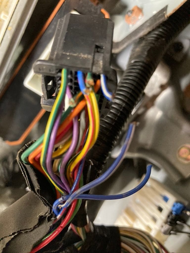

Well let me catch up here on this situation. I have been reading and troubleshooting stuff for several days, and realized that the DLC is not functioning as it should. Reading the shop manual I several times to access the test mode using a paperclip to no avail. I printed up all 5 pages of the Skid Control ECU and taped them together to so to see the functionality, and realized that several things were not functioning, maybe everything, as when I am driving when I applied the brakes the RF tire would lock up, i'm guessing that is a "limp home mode" thing. So I determined that something was up with the Skid Control ECU, Yesterday I started accessing the space behind the glovebox and found what looks like a mouse or rats nest on top of the glove box housing. Finally I got to the ECU and the problem became obvious immediately....four wires were broken to the top connector, which I will attempt to upload here. Probably eaten by rats although I also suspect that some shop was in there and may have broken the wires as the wire bundle casing had been cut down for more visibility. Who knows? So now I need to figure out how to de-pin the four. Any advice on this depinning would be appreciated, as I see the place to unlock the pins, but can't seem to withdraw it far enough to pull any pins out, I'm kinda sick of watching Utubes to try and see how to do this!
