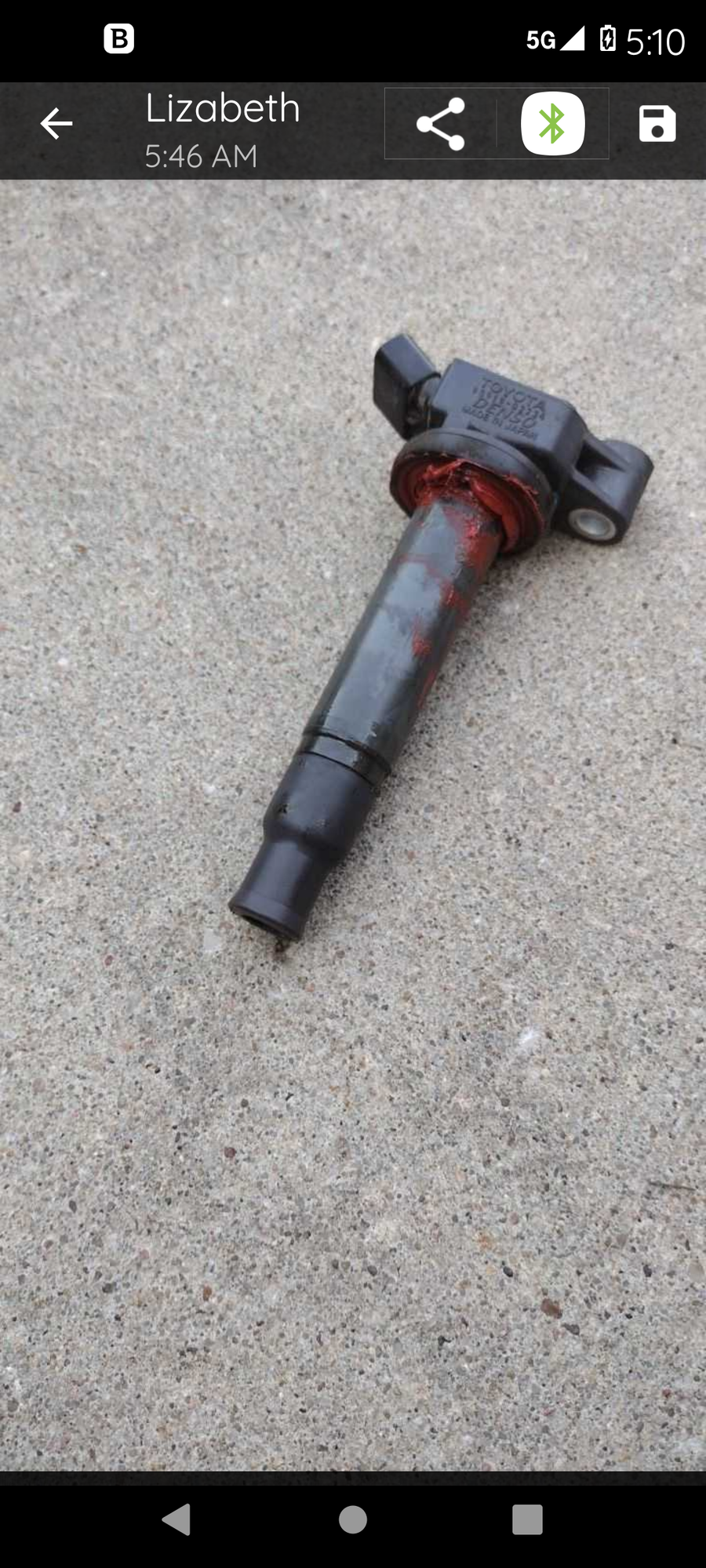

This is one of my coil packs pulled out of my 2001 Lexus RX300. There is oil around it and I'm wondering what this orange stuff is on it? I bought this car with 160,000 miles on it there was a bad oil leak and so I had a mechanic replaced the valve gasket and spark plugs. 8 months later I am driving it and loses power almost dies and check engine light comes on blinking same with with Vsc light. Someone replaced the parts of the muffler on it before I bought it and did a crap job. I don't believe they put a plans in. It has the old catalytic converter on it. It sounded a lot louder since it was misfiring. The codes were coming back bank 3 and 5 misfire. Occasionally when it would rain extremely hard I would start it the next day to have it blow white smoke out of the tailpipe which would completely disappear after it did its thing. A friend of mine brought over a experienced mechanic who worked on side jobs. He took this coil pack off and found oil on the outside of the coil bottom part and also there was oil in the spark plug. He suggested getting a new gasket set and replacing the spark plugs and going from there. He thought possibly whoever did the work must have not sealed the circle gaskets around the spark plugs which could be how the oil leaked or could be a bad coil. I'm just curious what this Orange stuff is on this coil pack. If the gentleman who did my valve cover gasket put it on there because he messed up or if you think it was on there before I bought the vehicle. I assume you have to take the coils off before you can get to the spark plugs and valve cover gaskets so he probably did it. The young man was going to help me out but ended up having to go somewhere for a bit of time and I was left to my own devices. Let's just say it cost an arm and a leg so I am going to try to attempt it myself with the help of someone who has some knowledge of cars and the detailed instructions on this wonderful site. I got the right spark plugs and a new gasket with the spark plug gaskets. I also got two coil packs. This friend of mine is a parts manager to help me get the spark plugs and a gasket and they only had two coil packs in stock. I am a woman but I feel like I'm intelligent enough, I can follow directions and I'm very good at puzzles even though cars are not puzzle, I have to try. I am familiar with cars even though I'm not working on but watched many people work on them. I was just wanting some opinions on the orange stuff they put around the coil pack and why? What is it. Thank you

The description is a bit confusing. "bank 3 and 5 misfire" doesn't mean anything as there is only a bank 1 and 2.
The vapor on startup may be nothing since it passes when the car is warm.
Don't know what "I don't believe they put a plans in." means
If there is oil in the spark plug tube the coil tube seal may not have been installed right. The orange stuff just looks like some grease, I doubt it hurt anything, don't know for sure why it's there. Maybe the installer used it to ease inserting/removing the coils, it's not really necessary.
So far it's not apparent that you need any new parts (other than possibly the gasket sets).
What are the codes you are getting?

Cylinders 3 and 4 are on different banks.
Bank 2 is towards front of car, bank 1 is towards the rear.
Obviously bank 2 is a lot easier to work on. Which bank did he find oil on the plug and coil?
You might want to consider buying a code reader so you can read and clear codes yourself. Very often one would clear the codes and see what code comes first.
Also could go to your local Advance Auto or similar where they will read your codes for free.

I thought it was 5 in the middle in the front maybe it was the one to the left of that.I don't know. I'm sorry I know this has got to be frustrating, when I don't know what I'm talking about. I can't really get a hold of him either.
The piece of paper he gave me has cylinder #3, #4 misfire for codes he did not write the number down. Then he also has random multiple misfire. Need to check plugs and coils which he did. So it was one of the ones in the front the coil had oil on it and the spark plugs had oil on them. I have 6 brand new spark plugs, brand new gasket set and two coils. The reason why I don't have six is because they could only get a hold of two. They only had two in stock.
It hasn't leaked any oil since the guy that did the job before it broke down. One gentleman I talked to said you have to be really careful threading the spark plugs correctly. I think it's the round gaskets. I think the guy who did the work didn't steal the gaskets properly and it leaked oil into the spark plug. I don't know how oil gets on the bottom piece of the coil. At least he said there shouldn't be oil there but I could have misunderstood him.
The guy who originally fixed the valve gasket for the leak and replaced spark plugs is the one I think messed up. We called him about it and he said oh it sounds like your coils are going bad. Well I'm not stupid.
I do not have a lot of tools or space to diagnose down the specific problem. I'll will just change the valve cover and the spark plugs again. Before that I can always start it and move the coils around to see if one's working in one spot and one's not. I've got the instructions step by step with the tools to use from online.
It just doesn't make any sense why he would put that orange stuff around the top of the coil. I think I've literally driven it 4,000 miles since I've had it. I put new tires on it and did the valve gasket and spark plugs. It has 166,000 mi on it I only paid for 3,900 for it. I have no problem working on it whatsoever, I have bren staying at a hotel for about 6 months looking for a place to stay and it's been a little stressful with my car broke down.
The orange stuff is silicone, your vehicle has a leak from the spark plug tube seals which are in the valve covers. The coil seals do not stop oil from getting on the s/plugs, it's only a dust/dirt seal.
The valve covers have to come off to replace the seals and this may not be a DIY for you.

You've got the right idea with "Before that I can always start it and move the coils around to see if one's working in one spot and one's not."
It sounds like you have limited space, tools, and funds. I wouldn't just start buying parts except maybe one extra coil. Coils are expensive, and there is no reason to replace working ones. You just replaced the spark plugs 8 months ago but we don't know what kind were used. The advice here is to use the OEM Denso or NGK plugs, and OEM Denso coils. Regardless whatever you've got was fine for 8 months and I've never had 2 coils go at once.
Get a code reader, you need it to work on this. You can get a Torque OBD2 adapter that connects to an Android phone or Iphone. I use BlueDriver but Torque readers are cheaper.
Amazon Amazon
If you believe oil fouling is the cause, pull out one coil and plug at a time, note the condition, note the part numbers, clean them, put them back
Clear the codes and start the engine.
Note the first misfire - say it's #4. Swap coils 2 & 4, clear the codes, start again.
If the problem moves replace the coil you moved to #2. Clear codes and repeat.
This is relatively easy and cheap. If your problems get resolved, great.
If there was fouling in a few months check your notes of which coils & plugs were fouled and recheck them to see if they are fouled again.
If the fouling is in the front bank that valve cover is easy to work on. Rear bank is a lot harder.

Can I plz add, I recommend when anyone pulls the coils for inspection to check the coil for hairline cracks.
This happened to me and was causing misfire.
So while the coils are out, a thorough inspection "while you're in there".
Also, if white powder is observed on the rubber tip this is carbon tracking IMO and also causes misfires and coil is junked since cleaning it doesn't help- the powder may run thru the rubber in my exeperience, cleaning didn't help me.
Both of these have happened to me- hair line crack and carbon tracking.
