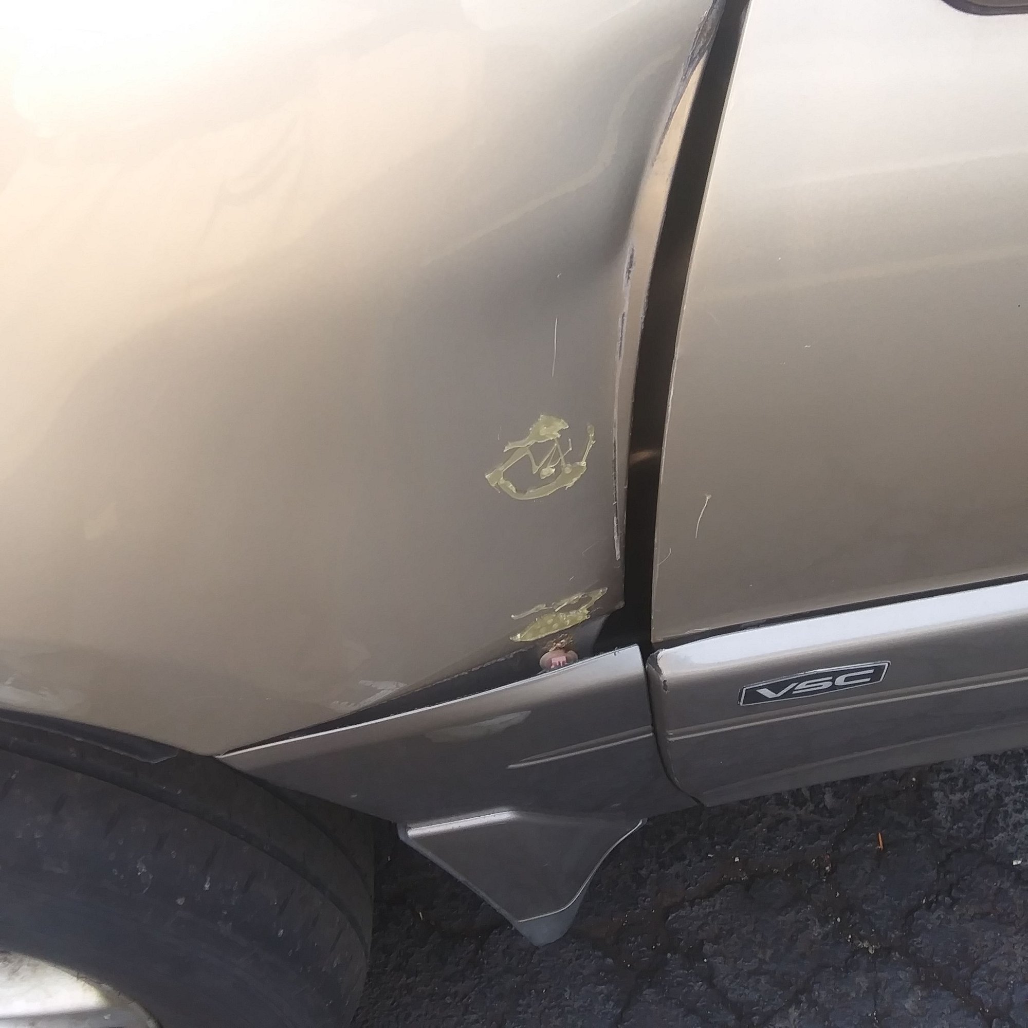

What tool would you suggest to remove this dent?
Basically it is keeping me from opening my driver's side door all the way. I tried glue tabs and slide hammers already, as you can see, the slide hammer just pulls the tab off and leaves the glue. Is there another tool I should be using, or did I just use the tab/slide hammer wrong? Thanks for any reply.

I would purchase the fender from salvage yard of the same color.
Salim
PS: Once you take the fender off, make sure the attach posts have not shifted [it seems they have and that is why the pulling has not worked for you]

That requires a welder, welding tabs and a bunch of other tools. Agreed find a used fender.

Take it off and hammer and dolly if you havent funds for a new one as this isn't going to pull out.

Wow! Maybe take the fender off, beat the damage out, and reinstall???

You might be surprised what a Paintless Dent Removal guy can do.
