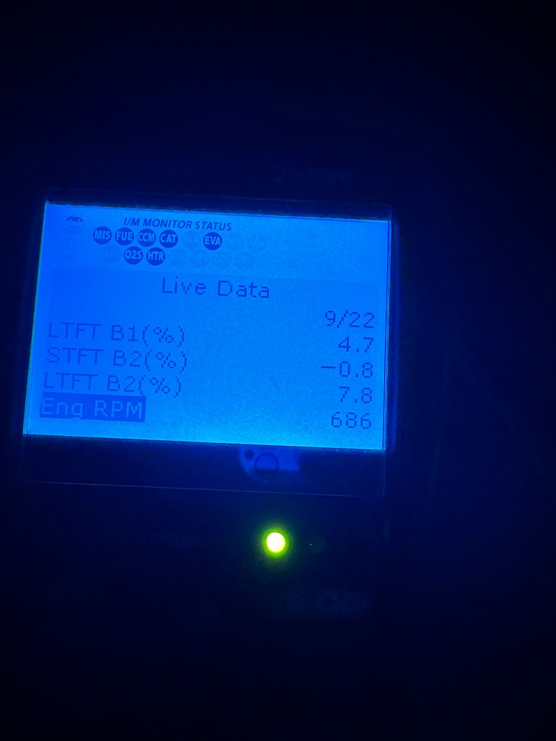

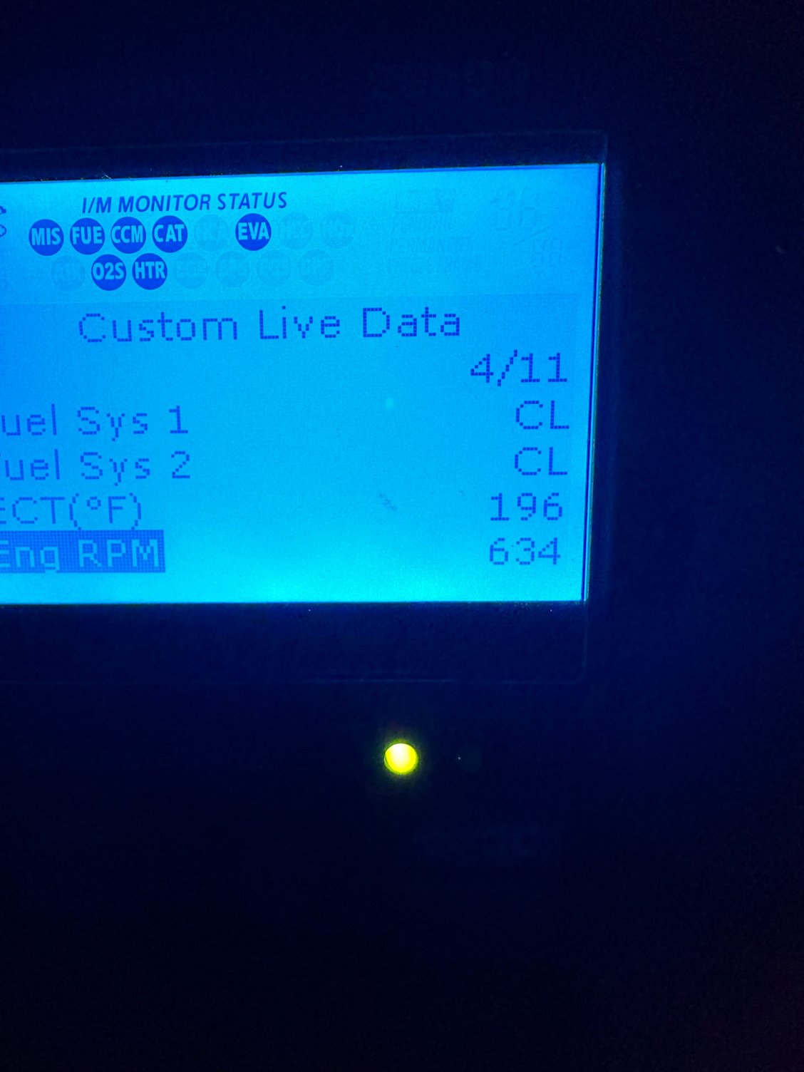

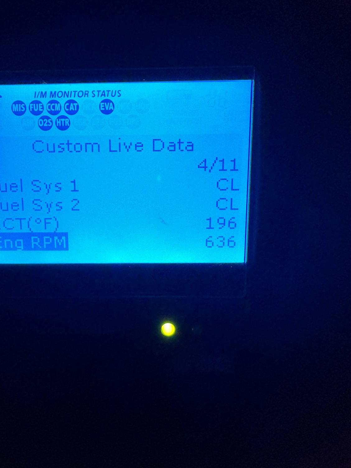

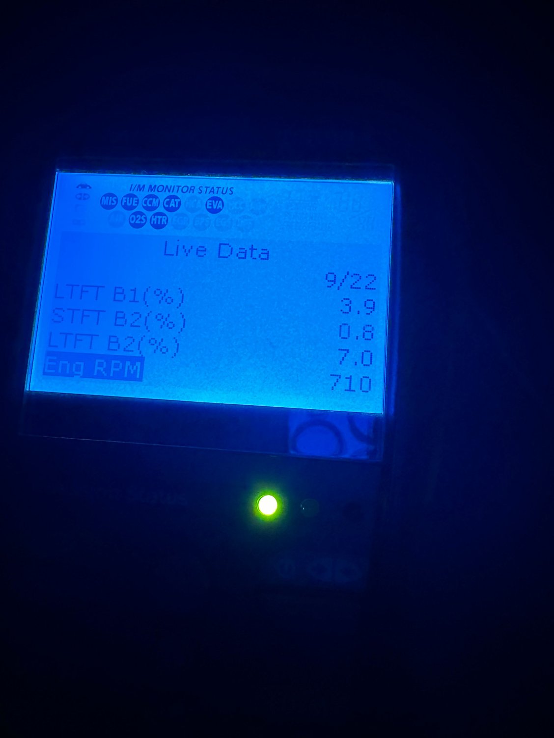

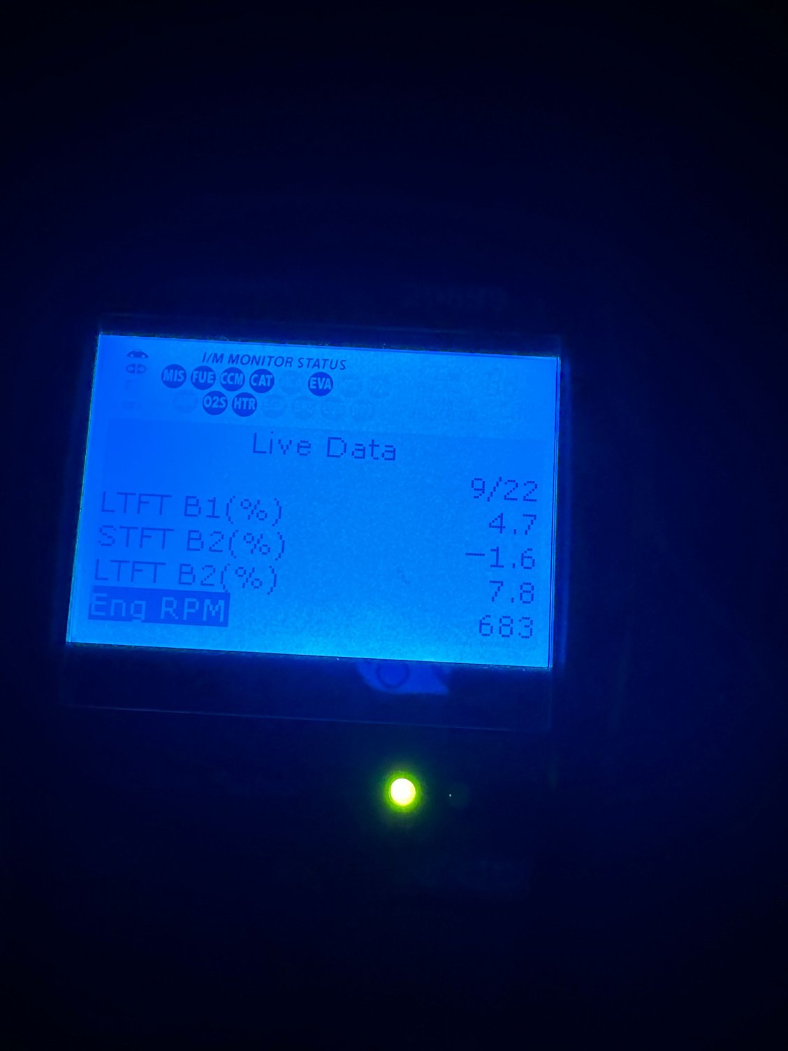

Ok so I checked the RPM’s in park and drive when the engine was completely warmed up.
The reading where the headlights are off and just the DRL are on, the idle fluctuated between 620-635 rpm’s in drive, and around 650 in park.
With headlights on, the idle was anywhere between 685-710 rpm’s in drive and in park.
So something is definitely wrong with the idle speed. The engine severely vibrated when I had the headlights on, then immediately turned them off, the idle drastically dropped.
Here are some pics of the live date from my scan tool. No CEL, no codes were found as well.

If you can charge your battery overnight. This eliminates excessive load. There may be some electrical load issue but lets get the IACV serviced/replaced.
Service your IACV. Take proper care as the screws have tendency to be jammed. Read the DIY.
Confirm the slug can spin freely [DIY has the angle of rotation].
Put it back [replace the screws if needed or desired]
You may like to reset your ECU or let the vehicle redetermine your new normal.
Salim
