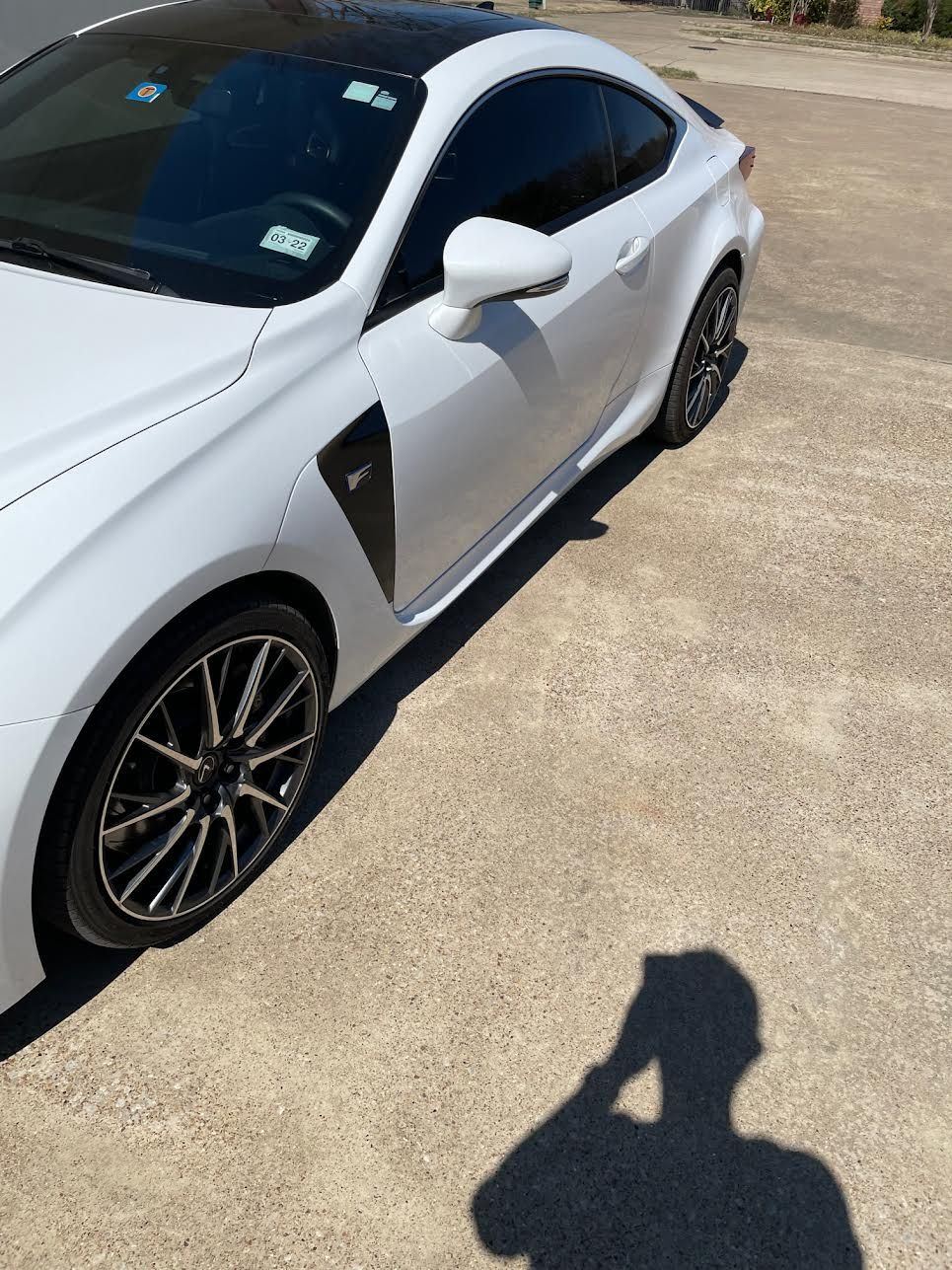

Put some on 3/3/22 (20mm all around), time will tell but I feel confident about them. i've checked them a few times and seem to be nice and snug after a few hundred miles. feels and drives the same.
I can be your guinea pig for however long! Car it totally stock suspension and wheel wise.
That's some nice fitment, looks great. What brand?
Old Mar 17, 2022 | 08:46 AM
BrandonX's Avatar
BrandonX
Joined: Jun 2021
Posts: 78
Likes: 43
https://www.evasivemotorsports.com/s...2x15-bore-601/
Picked these up from Evasive Motorsports. got help from rolla on 20mm all around. been really happy with the look. H&R seem to be one of the unanimous top brands for spacers.
