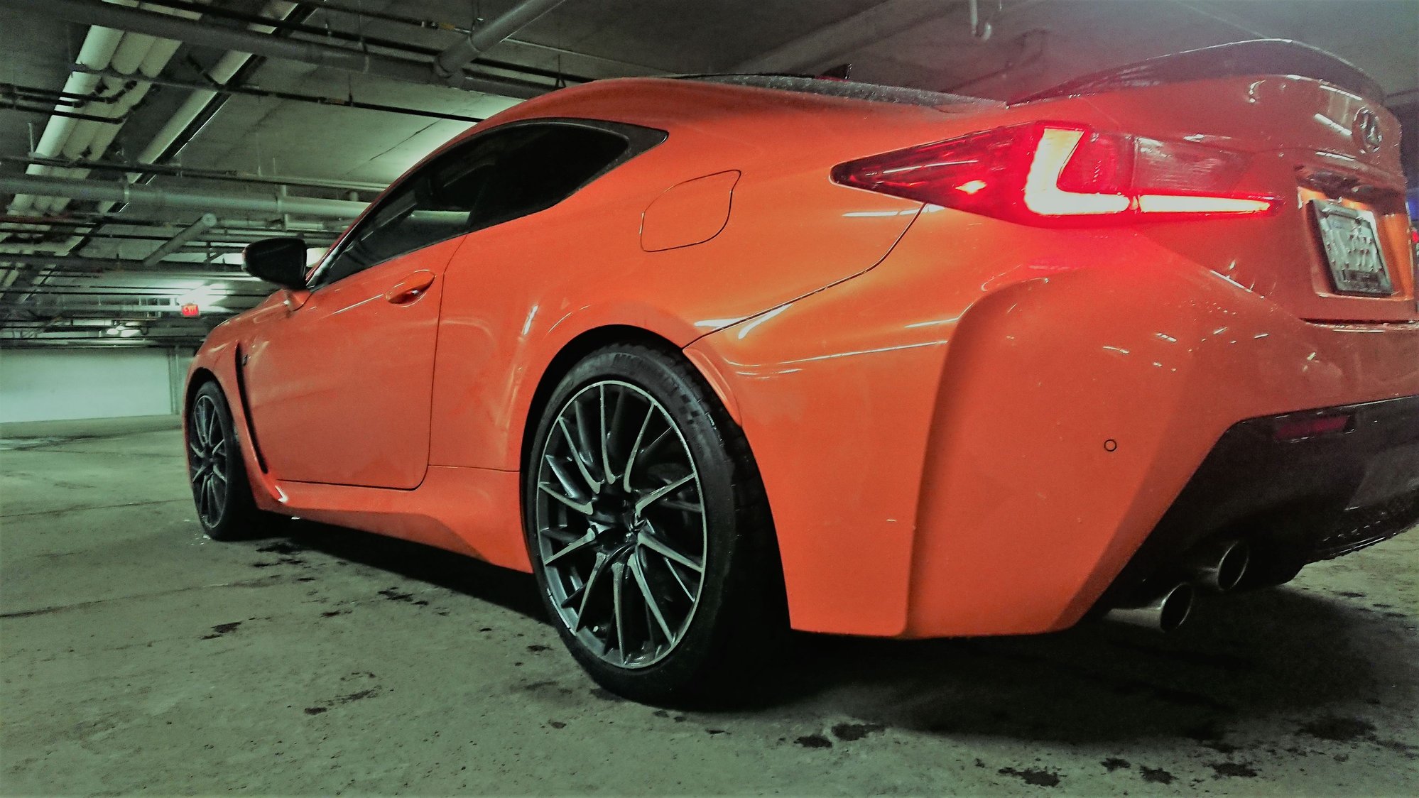

This is the picture I took over 2 years ago when I installed the spacers on stock height. It was with the OEM pilot super sport tires. Close shot of the gap with OEM suspension. Now, I have the Michelin Pilot Sport 4S tires with XL thicker sidewalls, which make the tires look more "meaty" especially on the sidewalls so there is a bit less gap now especially in the front.

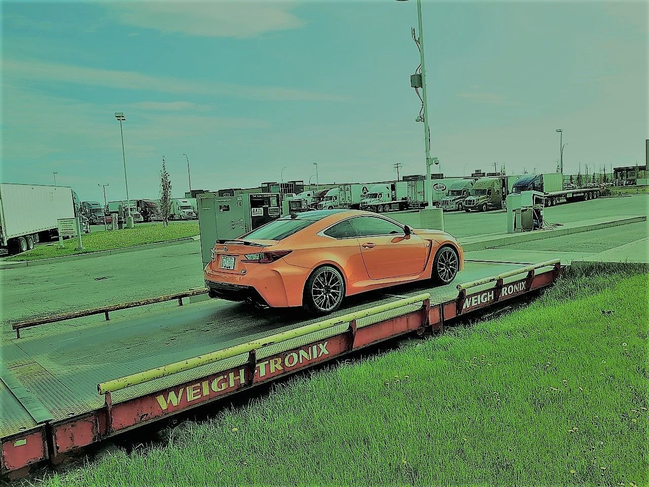

Hey man, my tire setup is the same stock size. 275/35 rear and 255/35 front. My current setup is the following picture. The gap is a little less because the PS4S (XL) have more "beefy" sidewall at least when they are brand new. I will see how they wear-in as time goes by. I have 15 mm all around.
If you have wider tires then you would want 10 - 12 mm max so that the tires don't stick out past the fender.
