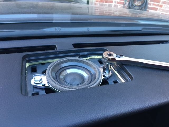

So this is the center grill and pops off easily. I used a smooth piece of plastic for scrubbing pans in the kitchen..to pop this off. Once off..remove the speaker with a 13 MM socket for the 2 bolts..lift out, and unplug the wire.

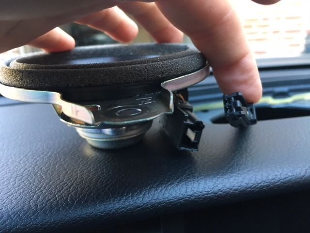

OK....so here is the difference of the factory speakers which looks a LOT like the radiator cap ;-)) ...look how small that magnet is on the left compared to the Kicker. So with the kicker speaker ....you'll need to dremel just ONE side of the kicker speaker...just ever so lightly to fit the factory bolt through it..

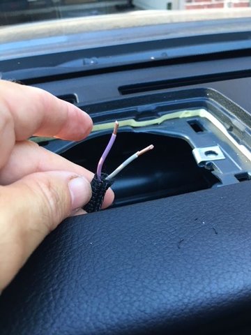

Ok...obviously out of order but just a quick view of the what comes with the speaker...wire and that's all you need ;-). Pull out the Lexus speaker and cut it...yeah...I know...kinda hard to cut it right ;-). Splice the wire and you obviously have figured out by the pics...the kicker speaker brackets will NOT reach the factory holes..standby for the answer to that...

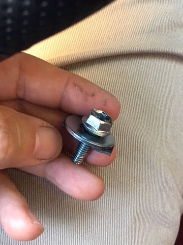

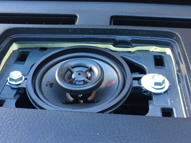

OK...so using the factory bolt, I installed a washer with 3M sticky tape on the bottom of the washer ) to cushion the vibrations and to help secure the bracket...I put the factory bolt in as a "CLAMP" to secure the bracket down. The sound is much deeper bass, higher treble with three tweeters...very happy with the mod...so there you are... after many years as a lurker..I can finally say I have "given back" ...just a little
Nice write up. the factory speaker uses neodymium magnets which is smaller and lighter, but the magnetic force/field is much greater than the ferrite magnet that is in the kicker. The kicker has a larger driver compared to the Lexus which will increase the sound stage.
