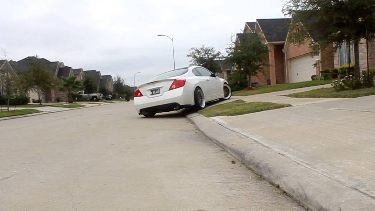

If your minimum clearance was measured with the car nose first, straight onto the ramp, then you should be good with the lip kit provided you approach the ramp at an angle. Reason is, there is less front overhang in this approach. To be sure, measure the clearance.

I made this template at the lowest point of clearance. I am posting this in case it is useful to others with a stock setup and a ten degree driveway. I always back into my driveway. But going the other direction should be the same.
The inch grid is lined up with horizontal when the car is level. With info from the distributor, the AS lip extends out 2-3" and down about 1.5". So I have about 1 inch clearance for a straight approach. I will have to decide if I can live with that. I can always unbolt it and clean up any scrapes in the future.
I could also follow your suggestions (thank you guys) by angling my approach, but we keep a minivan at the opening of the two-car driveway, and I would not want to be dealing with the hassle of that maneuver every day.
