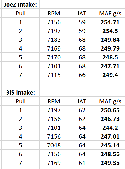

Try collecting some datalogs with your previous setup and your new setup. You can check to see if the Takeda Intake has a lower MAF g/s reading than the OEM setup. Just make sure that you document your data while the test conditions are fairly similar (ambient temperatures, humidity, Intake Air Temperature (IAT), etc.). Here's an example of how I was comparing different intake pipes (and currently comparing intake boxes):

Thats an awesome data graph. Very cool results...
